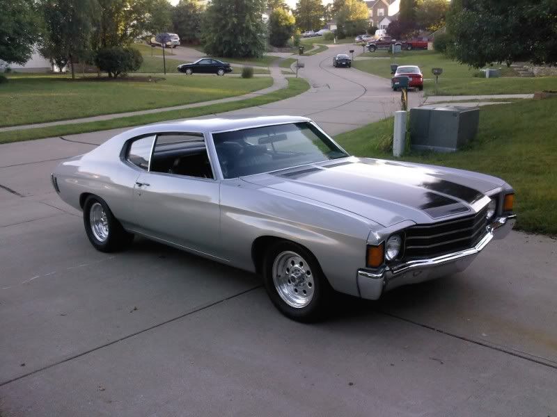

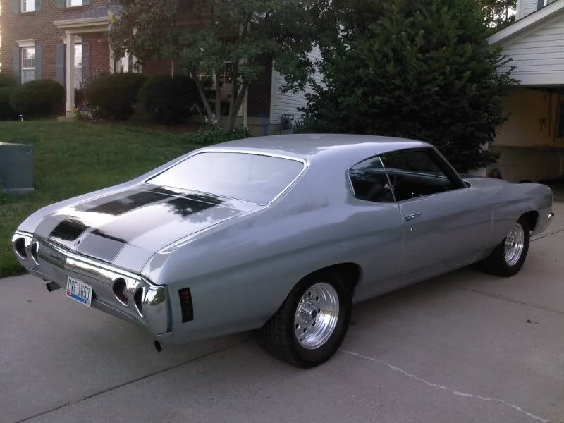

Cool car, I had a71 just like it. Good luck on the build, keep us updated!

Thanks guys will do! Werks that's a beautiful 71
