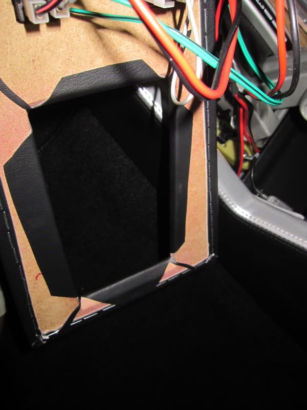

I receive so many requests for giving more information about the build that I decided to post some more pictures.
I had the center console covered by Alfred van Vliet. He did a very good job. He has an upholstery shop in the south of Holland. Unfortunately he did not take pictures during the build so I can only post the "after" pictures.
He covered the MDF with a thin layer of foam and on top of that he glued the vinyl to the foam. The silver is stitched to the black.
Here they are.
I am really satisfied with the result. Looks very professional.
Let me know if there are any questions.
