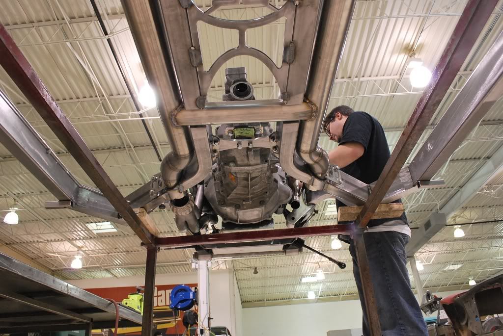

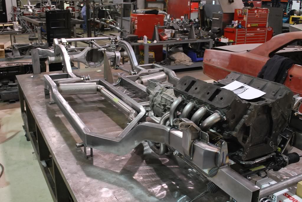

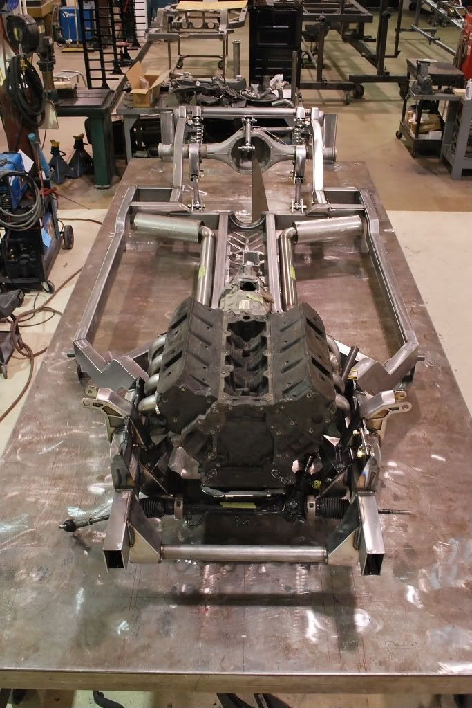

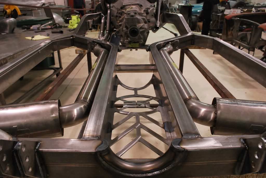

We set out to build a car that would perform as good as it looks, and look as good as it performs. The foundation for the car is one of our Fast Track chassis systems. Here are a few pics of the chassis on a frame table for the build to begin
We built a custom 3-Link on this car and made custom main rails that allowed for a side exhaust.

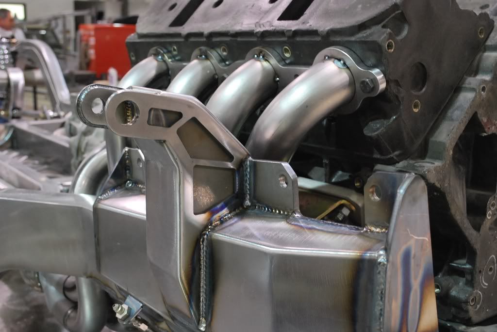

Custom lower coilover/3-link brackets

Wow. That chassis and 3 link looks sick!

Took some time building that bracket......looks like artwork as opposed to a bracket under a car. Nice details....

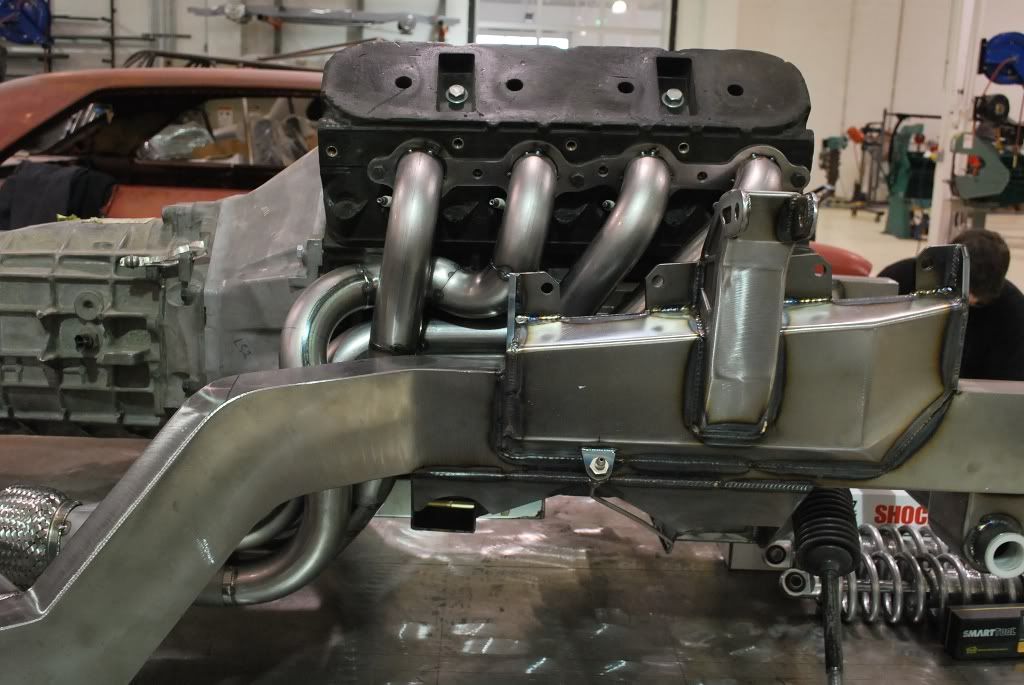

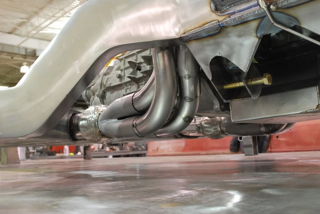

Here are a few more chassis and exhaust pics.
We did an oval tube for the H-Pipe that was recessed up into the crossmember to maintain ground clearance
Header fabrication
