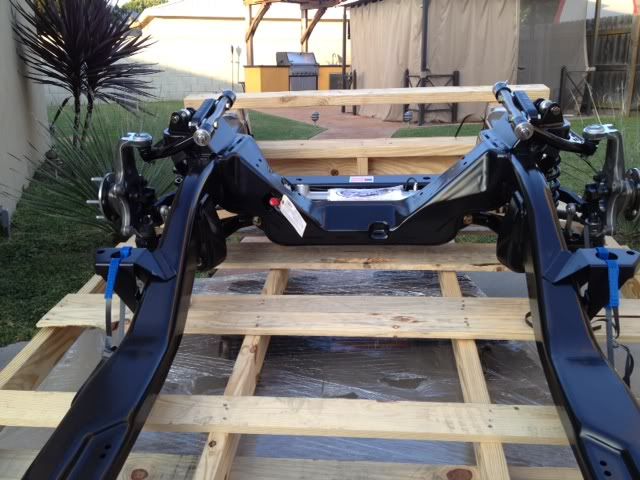

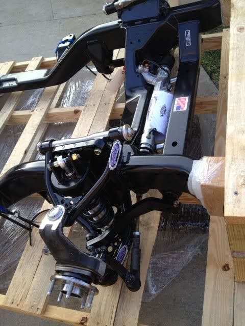

Finally got around to picking this thing up from Sal
and a few other goodies

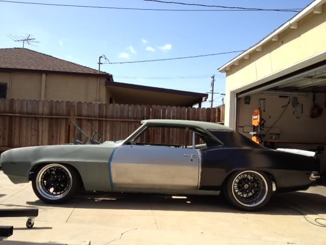

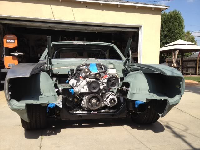

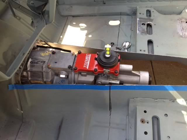

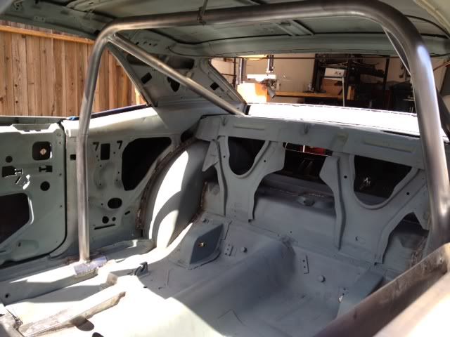

well finally got a few hours here and there to ove on project and this is where i'm at. installed DSE roll cage, sub frame connectors , subframe, and dropped engine and trans to see where I need to cut. as you can see on pictures need to make room for the magna against the firewall , raise tunnel for t56, and I figure I would build my own cross member. also been talking to mark @ street & performance in regards to relocating my ac compressor , and maybe my alternator ( the plug barely hits sub ).
and so the struggle continues

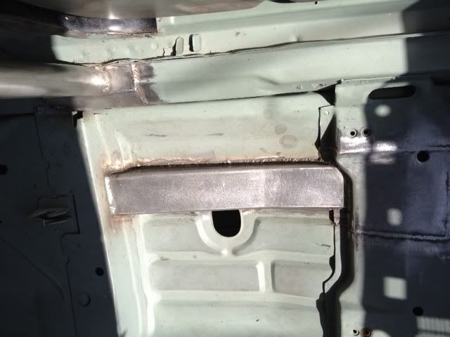

a few more of the cage and connectors
