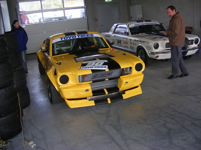

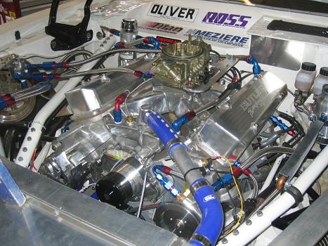

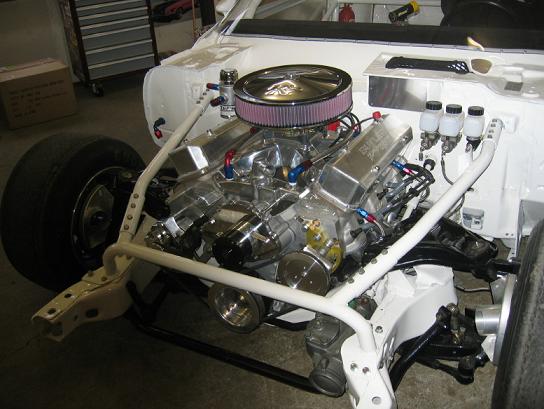

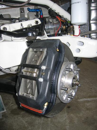

LOL bij the way that car hase ""stock"" lower A arms and SPC upper arms,
and custom euro made coil over shocks with 1000 lbs springs in front!!. and Wilwood brakes
I myself have ATS AFX tall spindels and Speed tech lower A arms and SPC racing upper A arms .Chicane kit(witch we disided not to use) and Afco Elite coil over shocks in the front.. and Brake Man brakes (best Brakes around if you ask me) Lee close ratio stearing box(same as the transam)
Im building a pontiac powerd first gen firebird to compeat against that pontiac powerd transam in the you tube video,s. ...
Point im trying to make is that you can do without a afthermarked subframe unless you whant to go a.al on weight and looks...

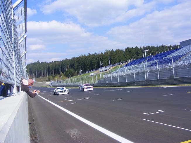

It wil NOT give you a advantage over the stock subframe.................have inclosed some pictures of that euro race league

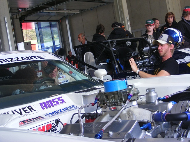

here are some more pictures. This was at the Red Bull ring in Austria last weekend we where at the Hockenheim ring Germany. Video,s where made bij our groop (picture above)
