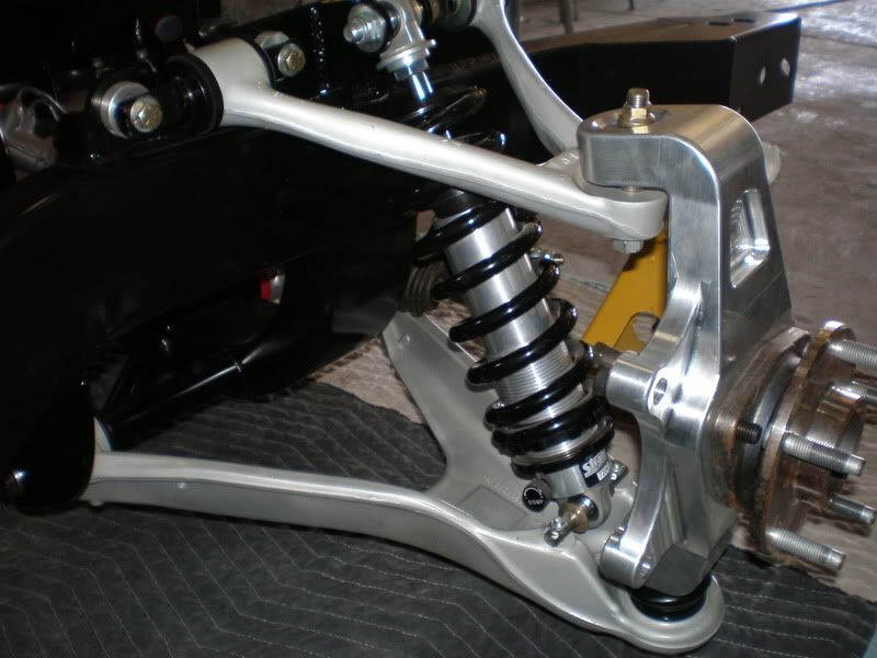

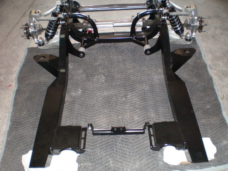

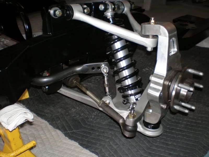

How about a little eye candy?

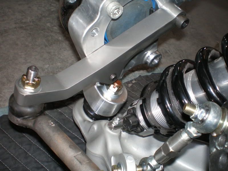

Where did you get the billet uprights?

  #246
Old 06-29-2011, 06:21 PM
Who's sub is that Ron??
That be one of them fancy Art Morrision sub frames ;-) Lookin' good Ron.

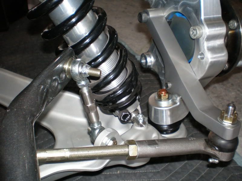

Originally Posted by MODO Innovations View Post
I really like the red pinstripe. Great job.
Thanks Shannon!
What that is is an AME sub w their HD adjustable sway bar, LG Billet Spindles, Pfadt Poly bushings and Lower BJ. Travis modified the Spindles to work as AME does and designed/oversaw the custom billet steel steering arms for the modified geometry. Arms are powdercoated silver and the uprights are cleared. It really was a big a** project. BTW, thanks to Trav, Rupp, AME Matt and Fernando (Killer67)...
G.
Thx G. I knew you'd spot it first! It kinda freaked me out when I saw the rack arms about an inch and half forward of the rack. Matt calmed me down though...
AH HA --- that's why it looked so familiar -- I had a Wayne Due with C5....
GW - I am not 100% positive, but I think there's some connection WD->AME. Maybe you can refresh me on that?
