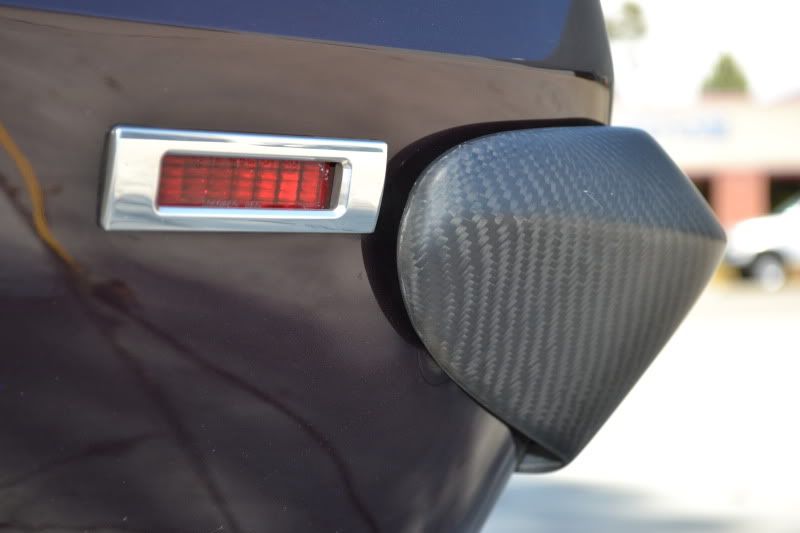

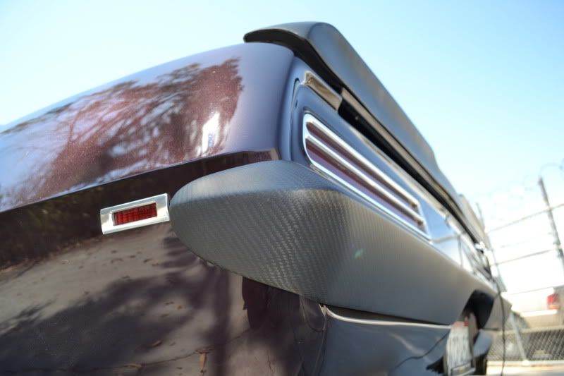

Originally Posted by 69MSA View Post
Hope these pics capture the angles you were looking for. If not, just let me know and I'll be happy to snap a few more over the weekend. I think part of the reason the bumper looks fat is because the spoiler is about half the height of a regular one. Also, don't mind the battery tender chord coming out of the trunk, hooked up to my I-won't-hold-a-charge Yellow Top Optima battery.
Oh, and before I forget, I've got a new issue to trouble shoot. we charged my AC and hooked everything up this week, and it isn't working. Basically, the compressor is getting juice, and the electric fans are turning on, but the compressor doesn't want to run. Any ideas? I'll be sweating my ass off in Fontana this weekend unless someone can come to the rescue with a tech tip lol.
Matt
The shots are perfect , thankyou, I really like it. The bumper is not on Anvils web site yet, I guess Ill give them a call and find out whats going on.
That car is stunning!! Thanks again Rich
