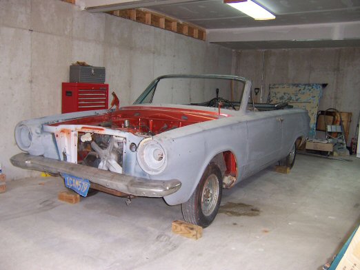

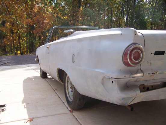

hello. i have a 64 dart gt convertible. im doing a 5.7/6.1 hemi swap. Bill at Reilly motor sports makes a front suspension unit. his unit is in alot of cars. i just got my car last year and itll take years to get done, but i want to do it right the first time. bills unit seems like the best out there. the new hemi is close to the same weight as the slant six i just pulled out of my car which is 60 pounds lighter then the LA series small block engines. i wont be road corse racing my car, my goal is to update an old convertible with new suspension and engine/tranny. havent decided what im doing for the rear.
