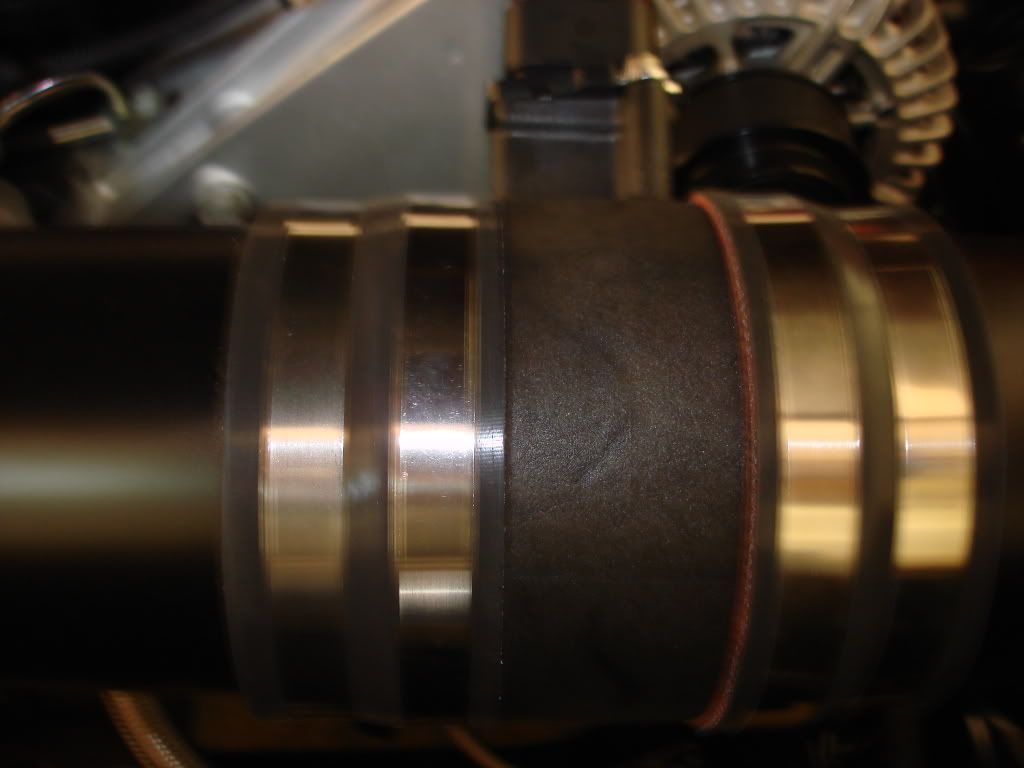

That Spectre coupler that you are using to connect the two intake tubes together with....how long is that by chance? I looked on summit and the longest one I could find is 3", but it looks like the one you have there is around 6". Thanks.

It may be hard to see from the other photo's, What your looking at is the PowerMaf plastic housing in between two silcone couplers. Both couplers are two inches wide. I dont have part numbers for them and they are not spectre. Some brand that was supplied with the MAF housing. The coupler up at the throttlebody is also a two inch made by spectre. Heres a closer look-Hope this helps- Rich

Thanks Rich. What is the primary function of this little plastic housing piece? Is it to extend the length of the tube and ultimately locate the filter further inside the fender? It looks like it's the same OD as the other (metal) tubes.

Its function is to house the Mass Air flow sensor. If you look towards the background of the pic you will see the MAF sensor protruding out. It is approx. 4 inches in length, many are made in Alluminum, mine is manufactured by PowerMAF made of some kind of plastic. It does extend the overall length of the intake system by 4 inches. The slot style Ls7 MAF sensor does include Intake air temp sensor as well, funny thing is I spent time trying to locate the sensor in the correct spot to avoid air turbulence problems and we ended up tuning the engine in a speed density mode which doesn't even use the darn MAF.
