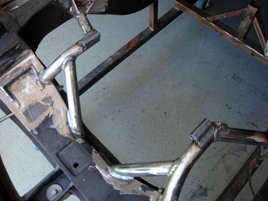

This past Friday and Sat I worked on my car. I was able to finish up the passenger side inner fender and get some progress on my engine mounts.

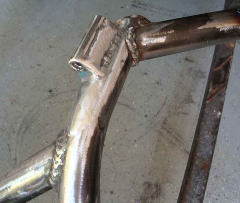

I was able to use my new Eastwood tubing notcher and it worked quite well. Of course, it makes a big mess as I'm using a lot of oil to keep the blade cool.
It took a lot of grinding, test fitting, grinding more, etc. to get them to fit. I first welded them with that "worm bead" and it looked more like gummy worms, so I went over them with spot welding for a cleaner look. I also made some gussets for added strength. Now all I need to do is make the plates that connect to the tube I'll use to trap the engine mount bolts.
What's funny is the pvc tubing I used still fit. I guess I made them accurate, or consistent, to my mock ups...
I also need to make a little more trimming for the engine before it goes back in.

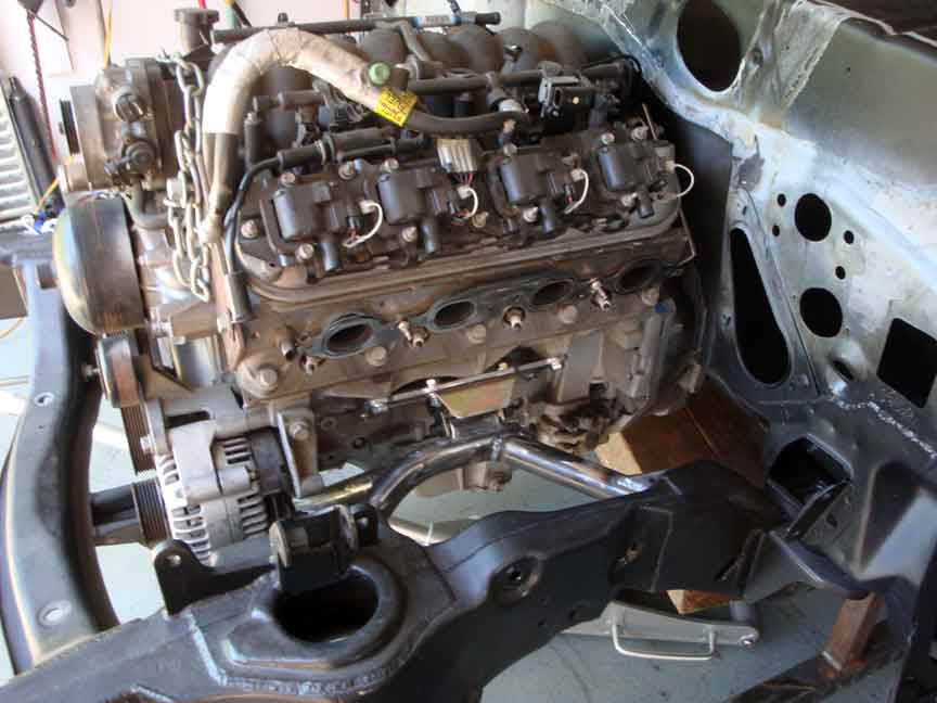

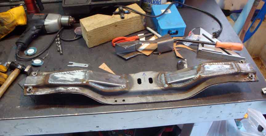

I had some time today to work on the car (I have to go in to work tomorrow and won't have a chance to work on it, so I'm posting my weekly progress tonight) but I was able to finally bolt the engine in today. After getting the tubing mounts ready I made the engine bolt tubes out of some chrome moly tubing my neighbor Brett (67Zo6camaro) hooked me up with. He also helped to tig weld them in as I don't know if my equipment is set up to weld chrome moly. I filled in the ends and bolted the engine in. Now I'm in the process of building the trans cross member and mount.

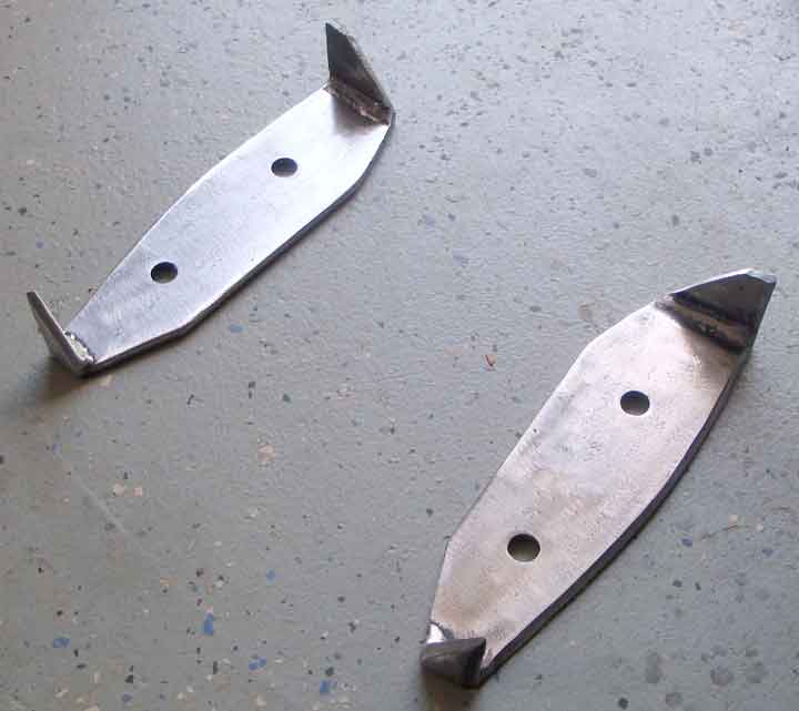

I'll be using the original trans mount and modifying it to fit. I'm working on "scalping" the top so it can sit higher (more exhaust clearance) and building some brackets to weld to the inner frame rails so I can bolt this new cross member where it needs to go. I should get this part finished up and installed next weekend.

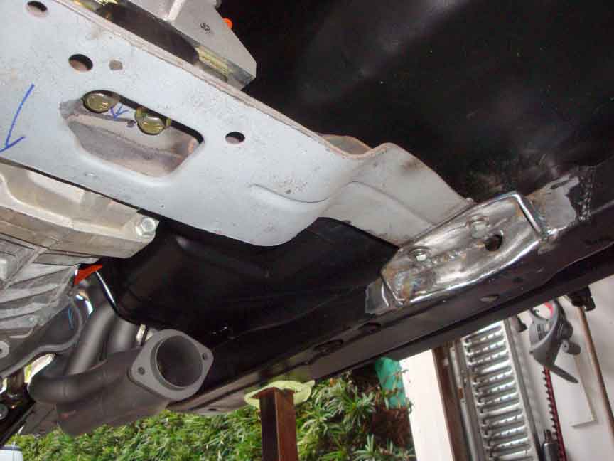

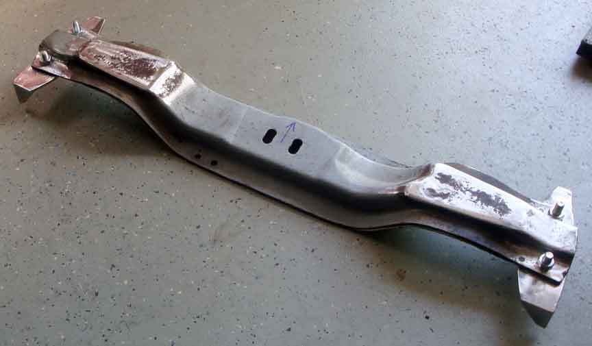

I had some time after work on Friday to finish up my trans crossmember. I was able to weld the brackets on and attach it. Nothing is torqued down, of course, but the bolts line up and the car is holding the engine.
Next weekend we'll be busy, so it'll be another couple of weeks before I can resume again.
