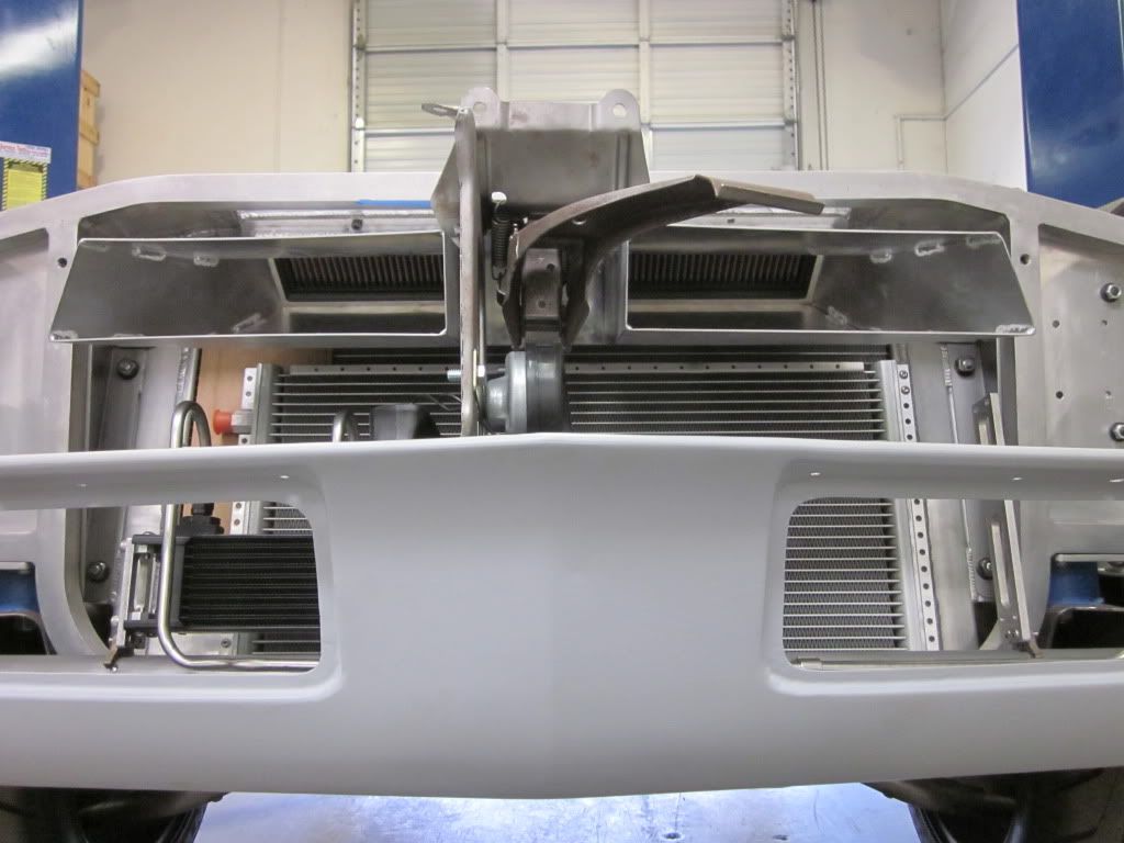

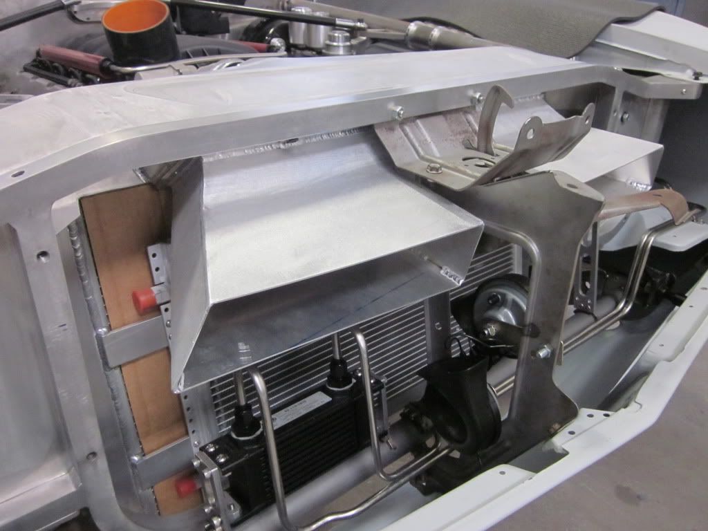

Hey Cris,
Is vibration going to be any issue with the hard mounts on those coolers up front? I was thinking the softer materials they are made from may fatigue over time and crack. Or is there a rubber spacer I am not seeing on my tiny phone screen?

Eric- Rubber mounting pads are included when you buy the Setrab coolers.. I need to machine slots on the machined brackets to get them in their...

Ok, got it.
I like the way you mounted them. Are those side plates your design?

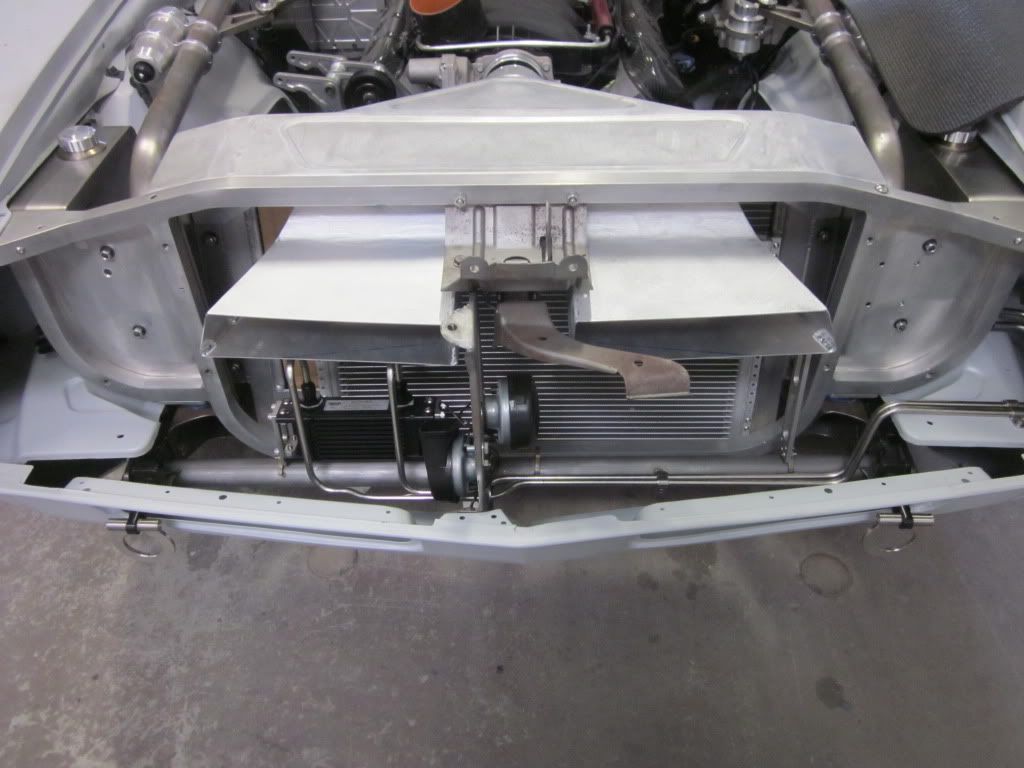

Some thing we whipped up on pcs of cardboard & machined real quick.. If I had to do them over again I would make a few changes.. plus need to add a top bracket on the oil cooler for added strength on the mount..
Another pic for you Eric..
