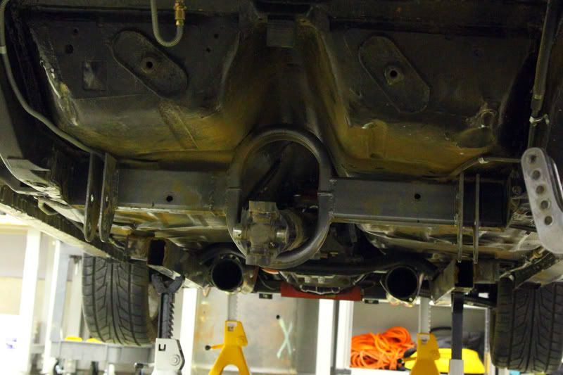

Looks a lot like the Checkered Racing setup that came on my wife's Carmaro. We just repalced it with a Chris Alston Chassisworks G-Link. We wanted a better ride quality at the low ride height we were trying to run. The top links were hitting the rear floor boards. We were also swapping out the 10 bolt anyways so it was a good time to change it all out.
It's avialable if you want it. Make me an offer.
Here's a pic of the newly installed G-link and Fab9
//Ed
//1964 Impala SS
//1966 Chevelle (Family Hauler)
//1969 Camaro (Hers...)

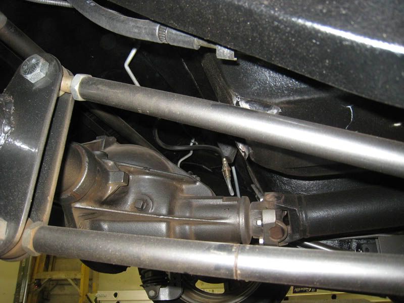

Larry,
Here's some pics.
Ride height when we bought Beth's car.
Where it was rubbing and angle of links at that ride height.
You can see where the links were hitting. Please excuse the dust. I have a half mile gravel driveway...
Ride quality was obviously poor with it setup this way. Though we never adjusted it to see where it could be before we decided to replace it. I sent you a PM with some more details on our experience with the car after we bought it.
