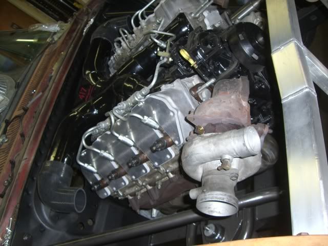

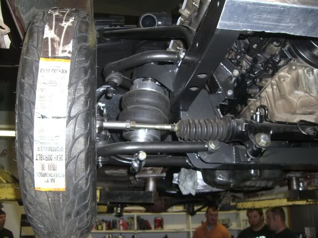

Sorry, ive just had alot going on
Cylinder head water plates
LBZ stripped and cleaned
Front MustangII style clip painted and installed along with firewall smoothed
Dual Battery box hidden
Uder shot showing air bags, mounts, and underside
New valve covers.... (anyone interested in some??) and the twins being mocked up
All air ride controls hidden in a Vintage suitcase mounted in the rear
Making the 4L80E fit.....
All covered up...
New subframe connectors along with Trans mount incorperated into it..
New dual willwood master cyl setup
Starting to come together
The car aired out...
