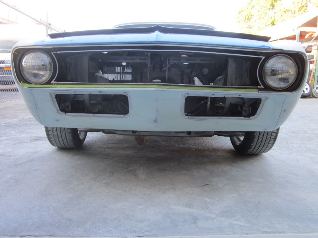

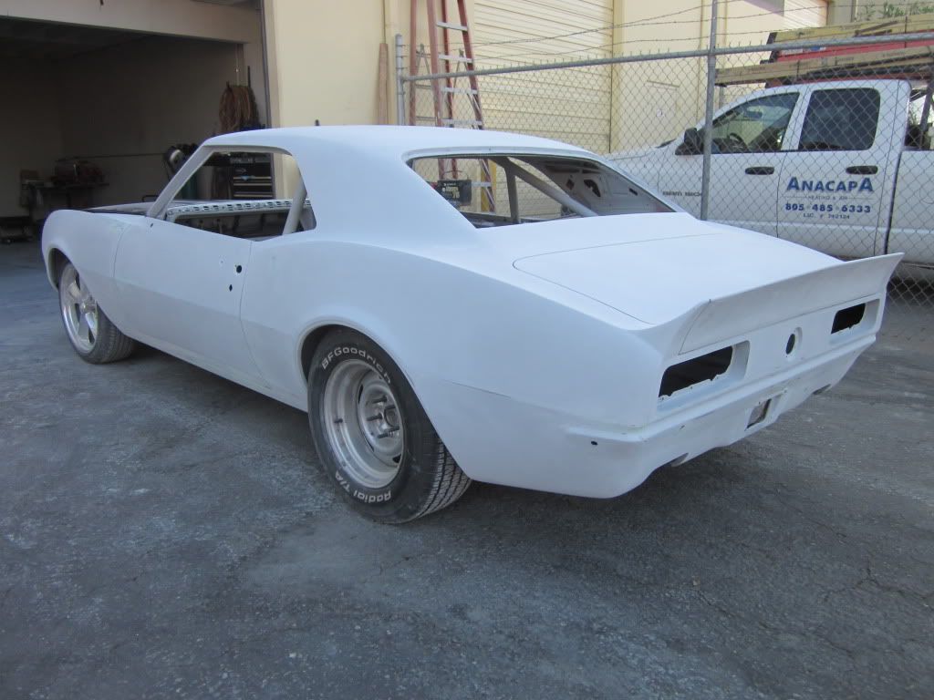

The owner has been asking me.. When the hell you gonna paint the damm car! It is a "Race Car"... It doesn't need to be perfect... My answer.. is the car will only be as perfect as I can get it only once in its life time.. After that you can thrash on it all you want.. I gotta thank the owner for letting me go above & beyond from what the project started as..
The car will be painted late next week.. My crew has been on 12 hr shifts & have agreed to come in & work this Labor Day weekend.. will be BBQ for them all weekend!!
It has been a pain in the ass to get the grill to fit the I want it cause of all the components not fitting that great.. then I remembered that it didn't even fit this nice from the factory.. We had to cut & splice the head light buckets for the headlights to fit centered on the trim.. I got the headlights from Headwinds.. Thanks Eric!

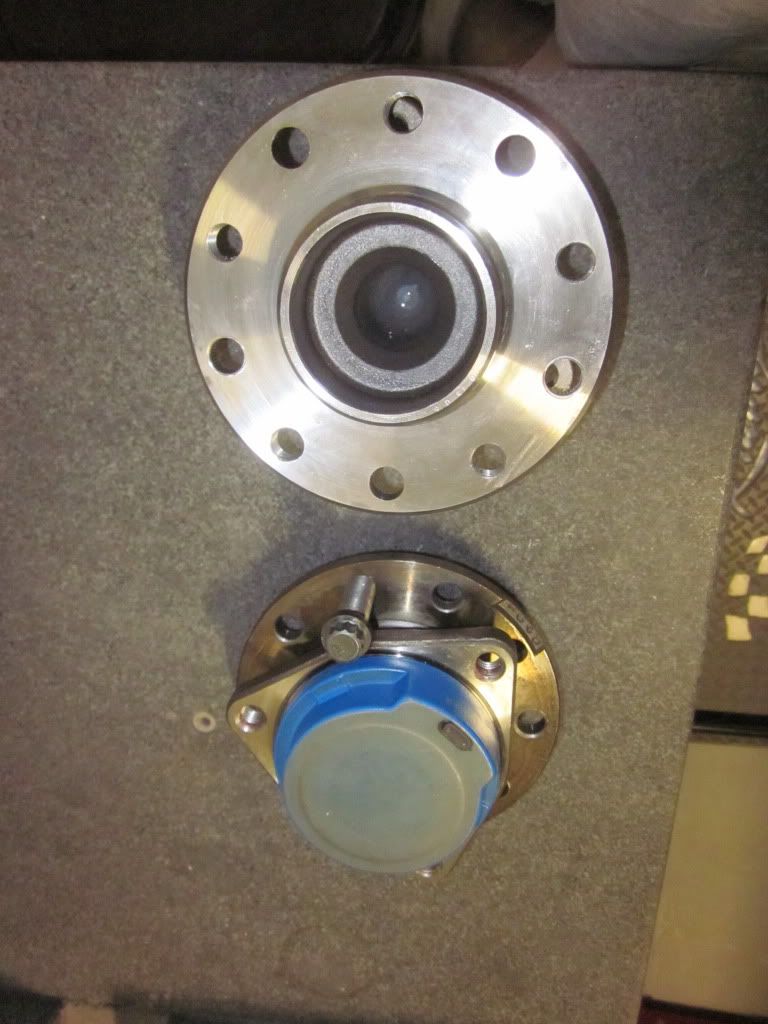

The one thing that has always driven me nuts is when you have metric studs on the front with the C6 hubs & 1/2-20 studs on the rear for 9 inch Ford.. Sent these out to the machine shop to re-drill for srcew in studs.. Now I can run 3 inch studs on all four corners with Trans Am open lug nuts..
Concentric within .001 & we build a fixture for us to convert the rest of them here @ the shop..
