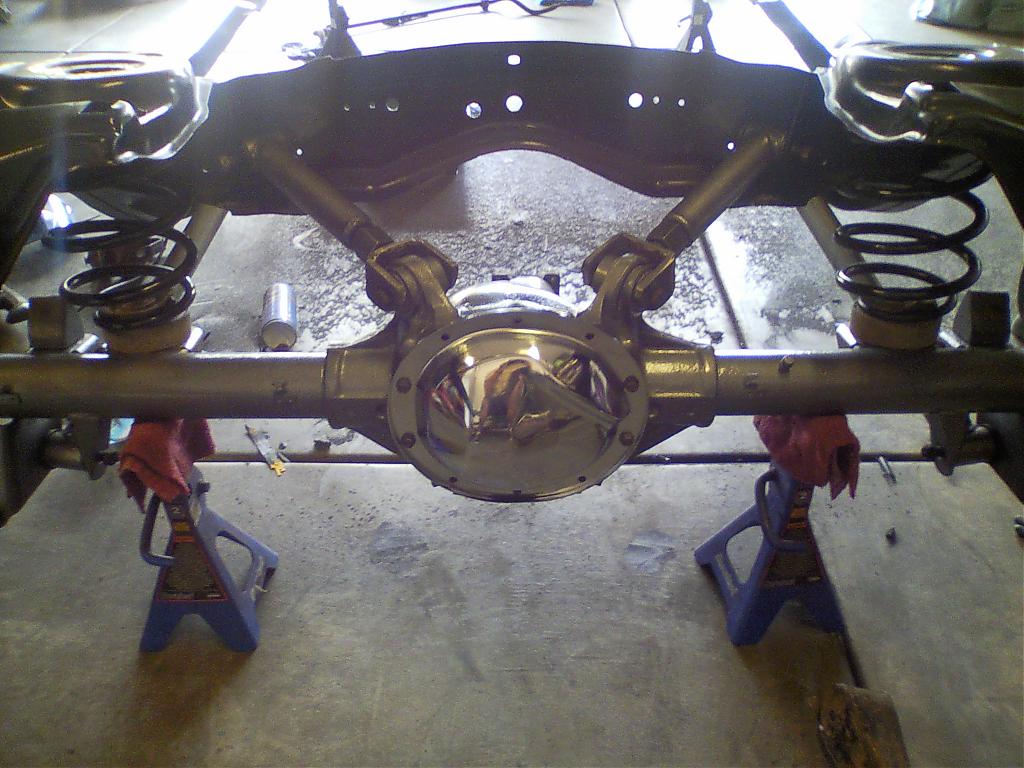

here is one picture:

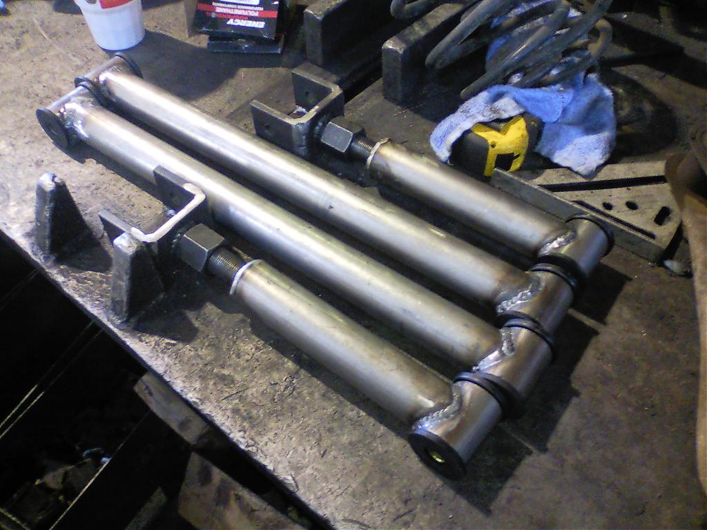

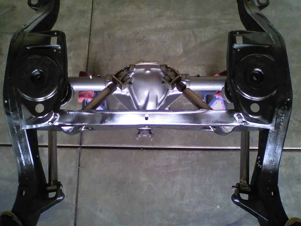

Two more:

What i would suggest will be different than the other vendors on here, obviously.
Speedtech uppers
our protouring sway bars are as good as you can get 1 5/16 front and 3/4 adjustable rear.
http://www.speedtechperformance.com/...rod/prd140.htm
http://www.speedtechperformance.com/...rod/prd252.htm
let me know if you have any questions.
Blake Foster
