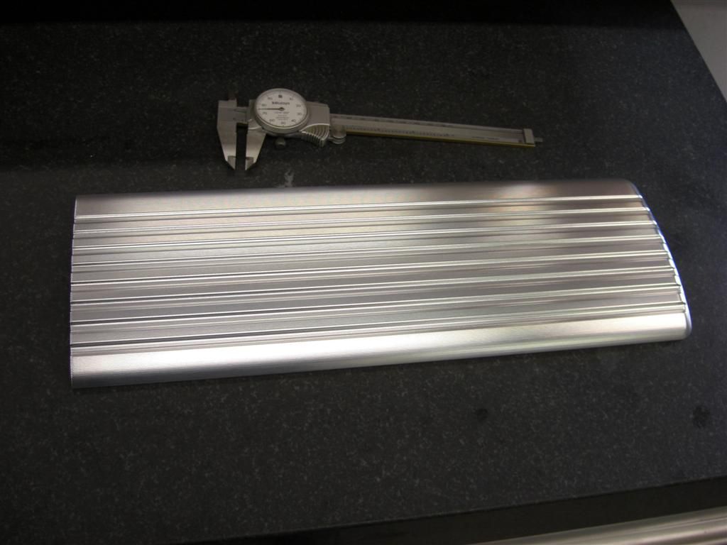

Glovebox
So we decided a while back to take 2 glove boxes and ditch the speaker grille in the middle and make the glove box go all the way across. Plus we thought when chromed it would pop. We we got the glove box roughed in an Steel, then sent the glove box and speaker grille cover to our own Lat-g super hero, Bob Braga.
Bob digitally scanned the parts and then made the outside face perfectly flat while keeping the fit of the parts we sent him intacked. We then sent that Solidworks file to my machine shop. I kid you not, 1 week later we had these in our hands to fit before chrome.
Then we fit them them to the truck before chrome.
Here we are yesterday, holding up the chromed speaker grille cover. We are waiting for the glove box still.

Thanks for the work Rodger. Can't wait to see this truck at SEMA.
Parts were sent to me. I laser scanned them and then reverse engineered the part in CAD. Made some custom changes that Roger wanted to add. Sent the files to his machine shop.
I can't believe he machined this stuff so fast for you. Hurry up and fit it to the hood I want to see how it fits.

It's not here for Saturday delivery from UPS and the truck is being assembled 2 hours from the shop. We will fit them on Monday.
