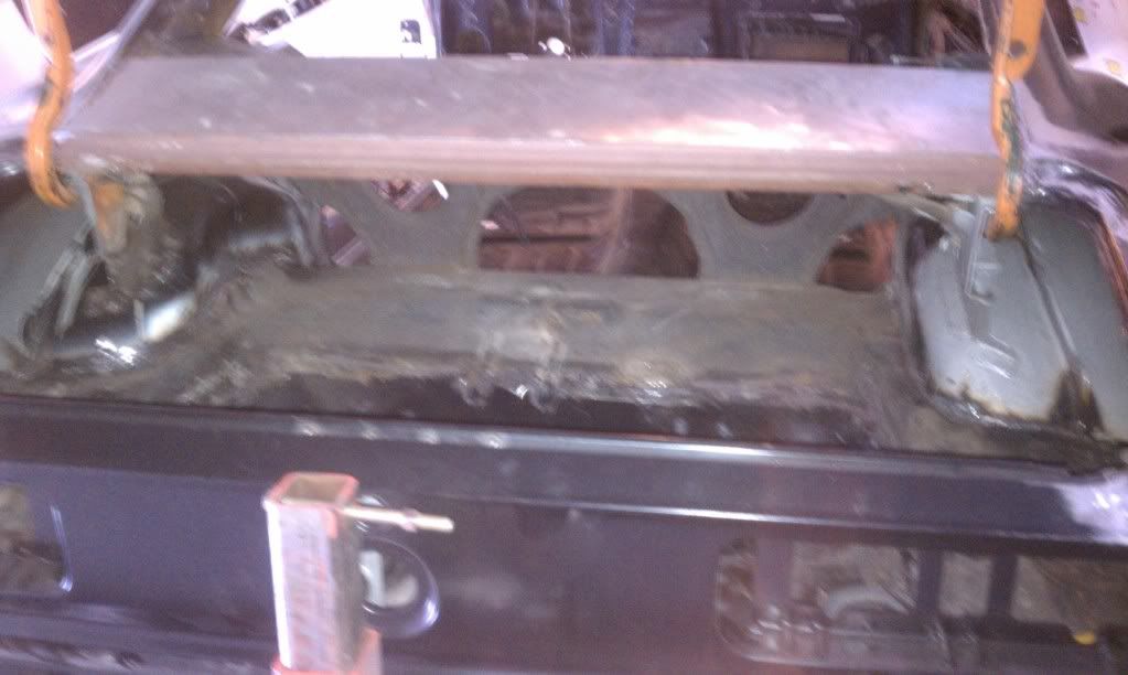

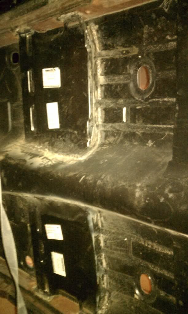

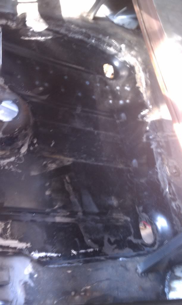

Spent most of the day cleaning up welds and putting the gas tank supports in finished up the trunk area, shooting to have the bottom sprayed by next week.

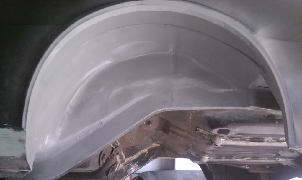

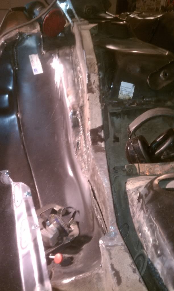

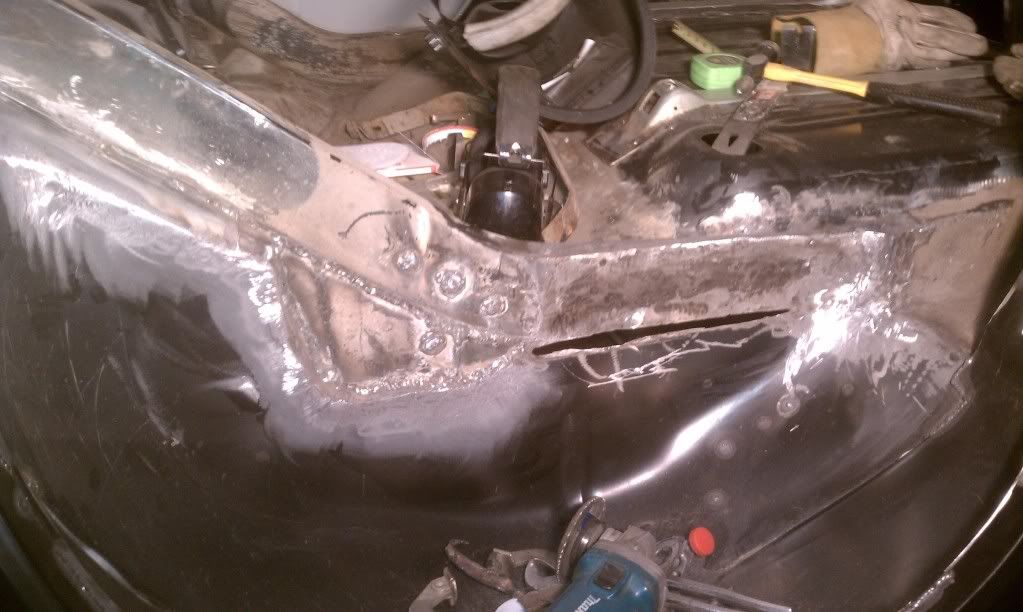

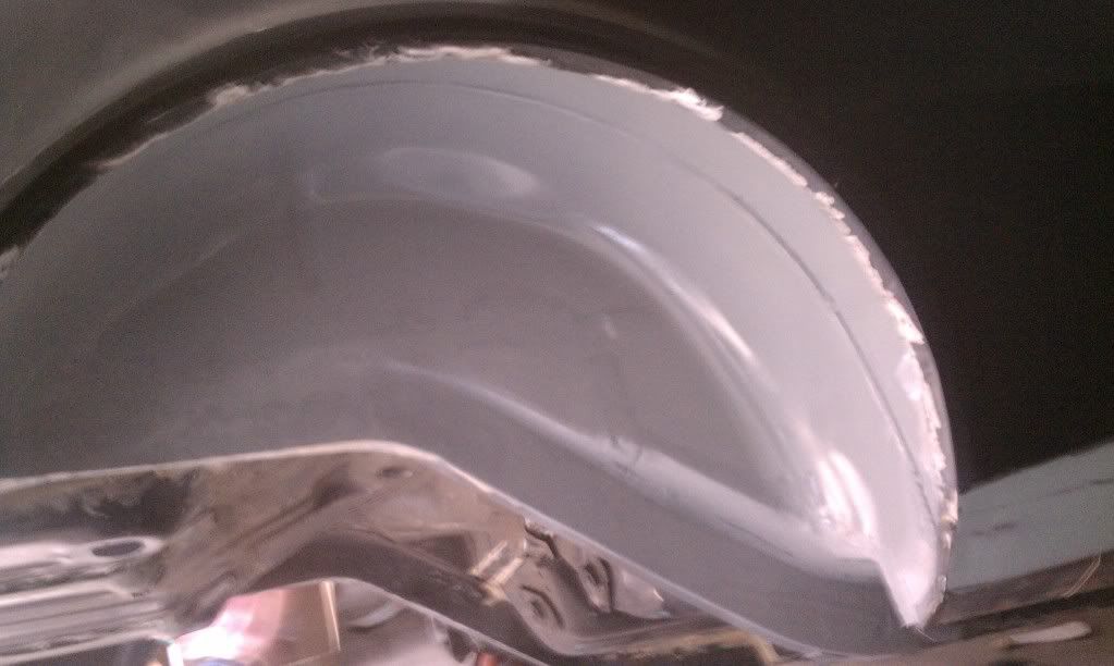

So I decided to finish my mini tub I didn't want to cut my frame but now that I am designing my own 4 link there will only be trunk weight to support so I went ahead and cut it. It took about 2 hours to get it done I have to finish up the front of the tub but this is what I have so far.
I have some grinding to do in the front but my grinding wheel broke last night and I thought it was a good time to quit.

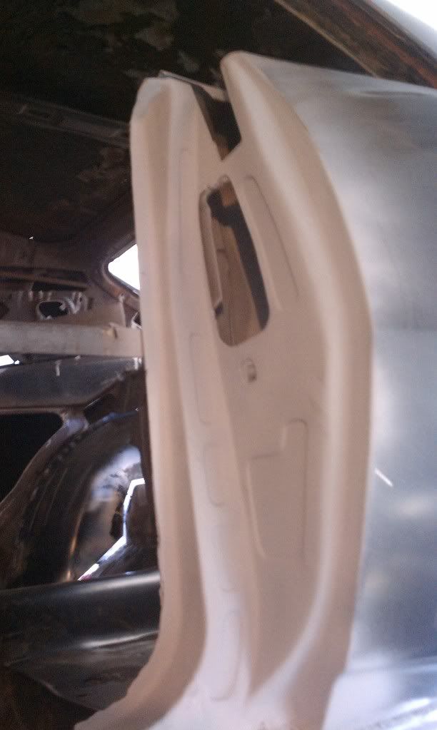

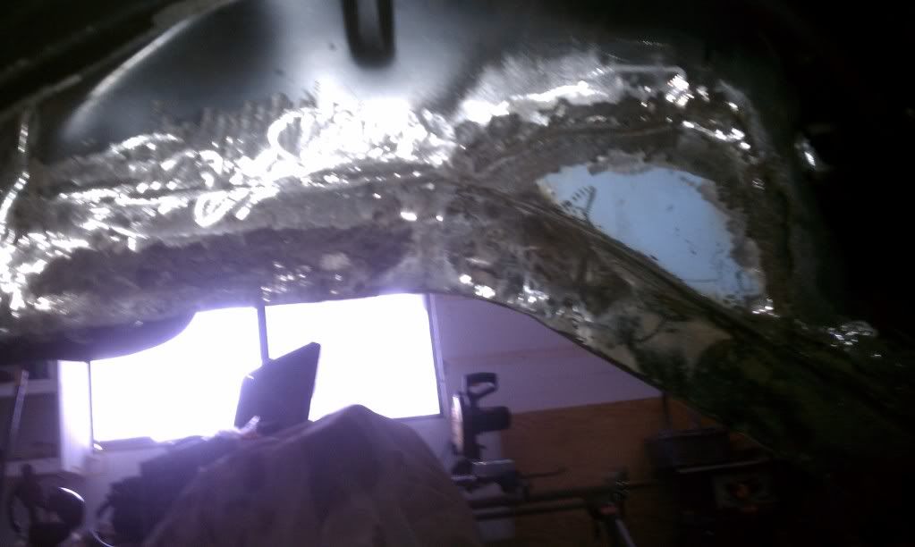

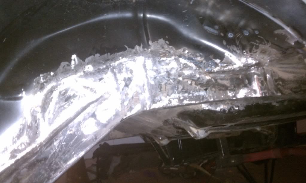

i got the wheel tubs all buttoned up a little more grinding to do but I am on the home stretch. I finished up all the welds on the floor and under the trunk and my big milestone was actually pulling some of the supports off. I actually have a car back.
I used some of the original sail panels to cover up the cut tubs. Just a little piece of history back in the car.

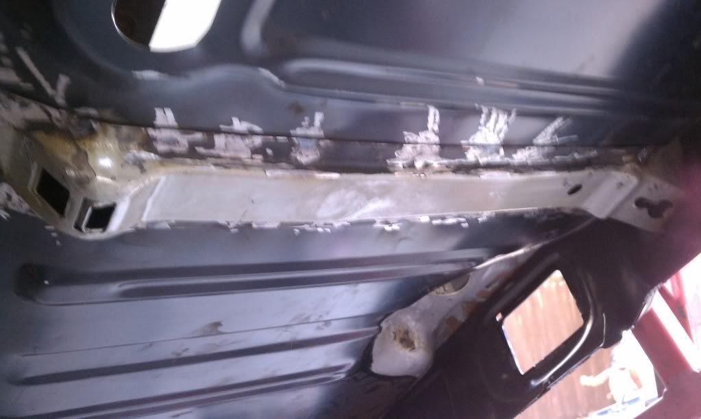

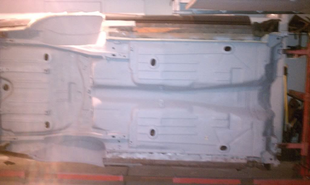

Today I got all the welds cleaned up, tubs primed and the trunk welds skim coated sanded and POR 15 over the whole trunk.

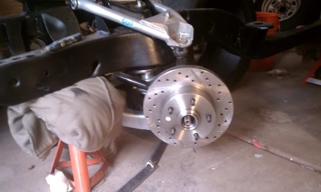

I also got my new brake rotors and hubs in took a quick pic need to pu all the new bearings in though.

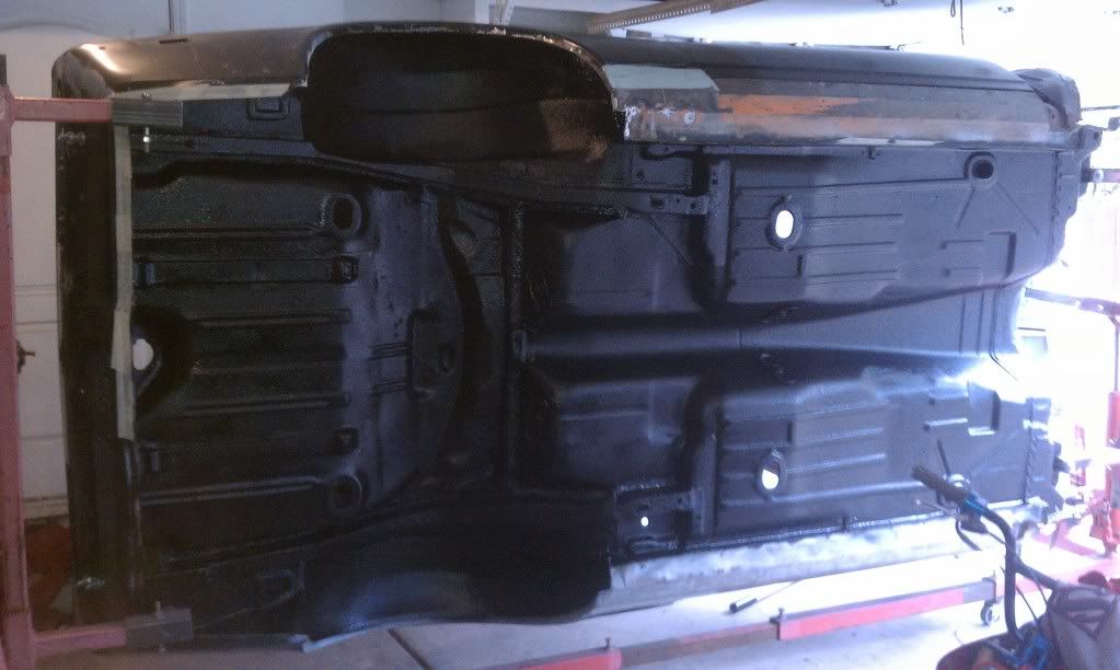

I welded in the seat mounts today and finished welding the tail panel found a couple spots I forgot. Sanded the bottom and got it in primer ready to shoot upol tomorrow.

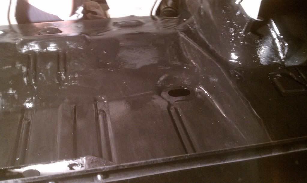

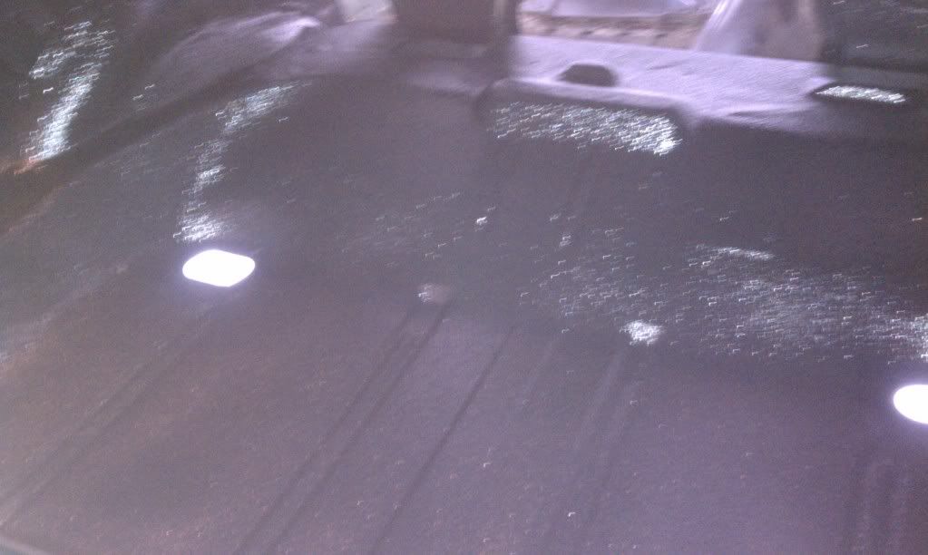

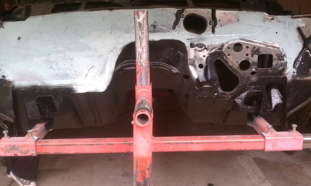

Today was kinda cold but I wanted to get my u pol sprayed before I went to work for the next 48 hours and lost my window on the primer but it was so cold today. I put a heater in the garage for hours and finally got it to 70 degrees so out came the u pol I sprayed the bottom and up the base of the firewall to the line and around the tranny tunnel. I also had one bottle left so I sprayed the trunk area. This stuff lays down so easy and it looks like Line X bed liner. I would definitely use this on all my projects.
