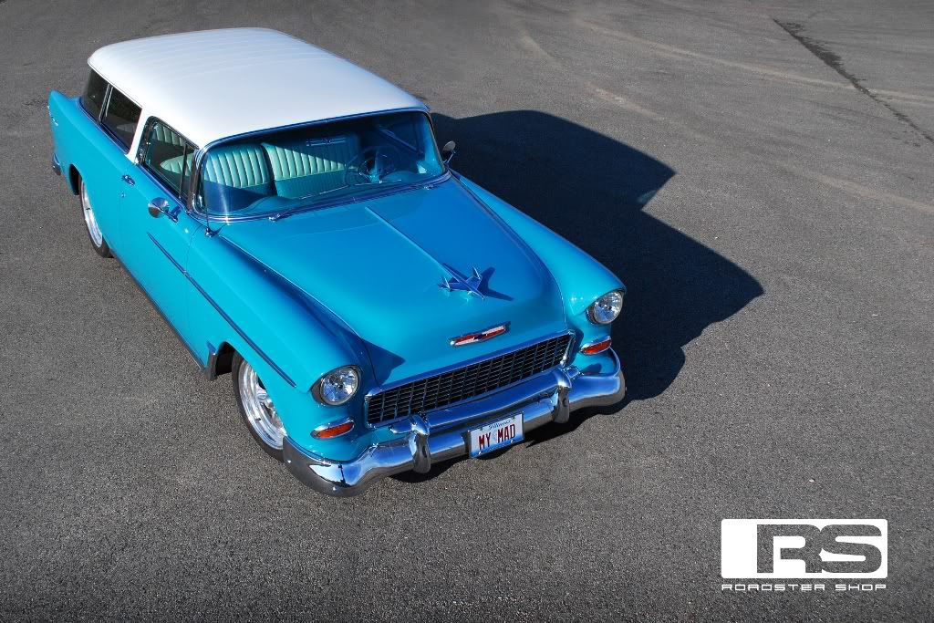

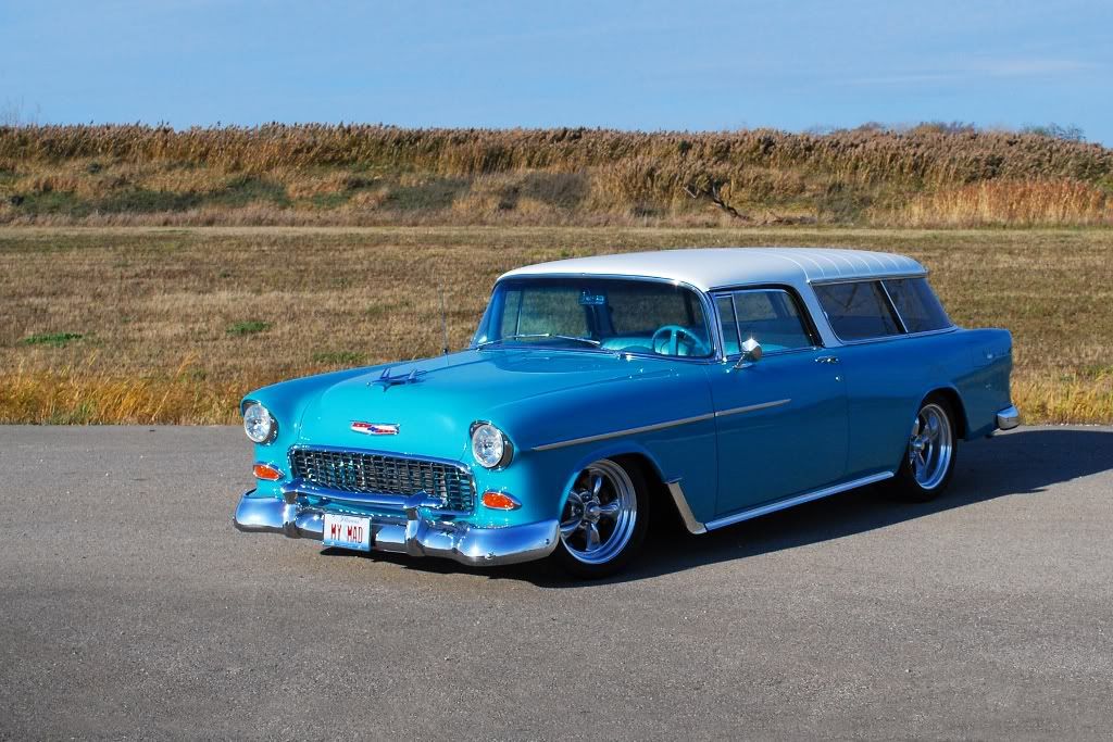

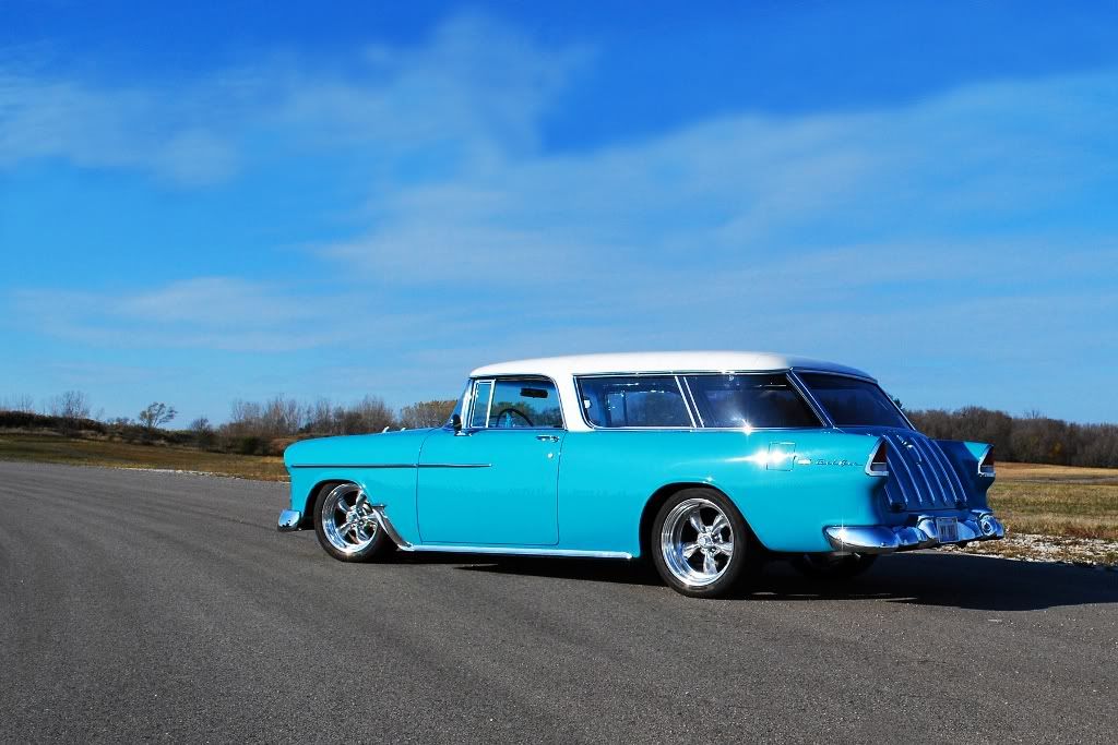

Here are a few more recent projects that I forgot to post lately.
We wrapped up the 55 Nomad about two weeks ago. Pretty cool, resto-mod type build.

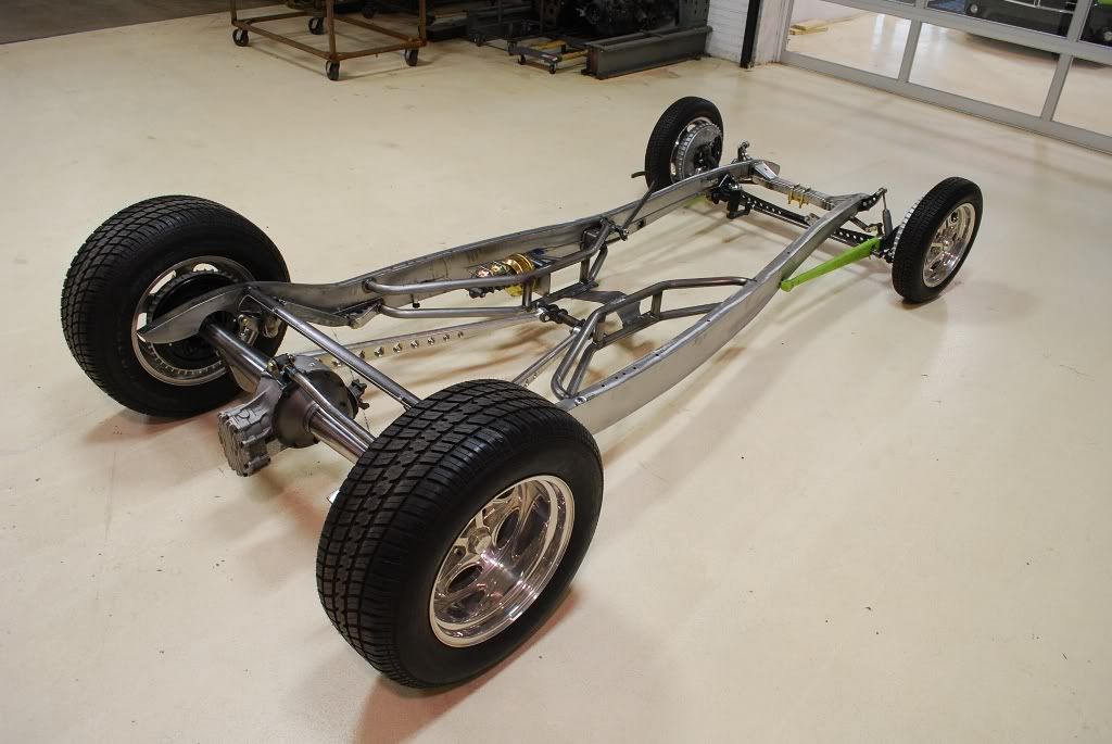

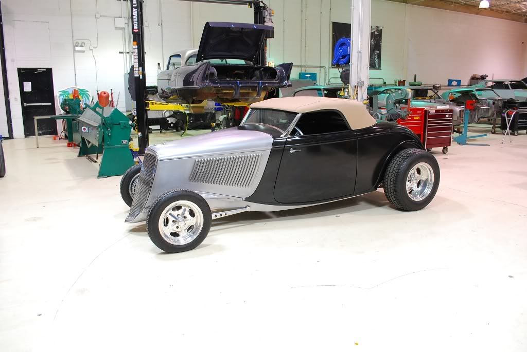

Here is another 33 with some unique custom touches.

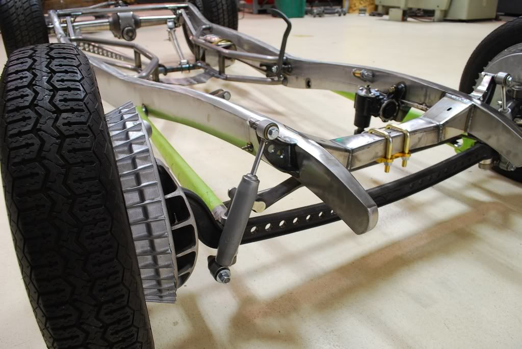

Custom chassis using Johnson's Hot Rods Wishbones front and rear, Winter's Q/C, 5" drop axle and Buick style brakes for a real traditional feel.

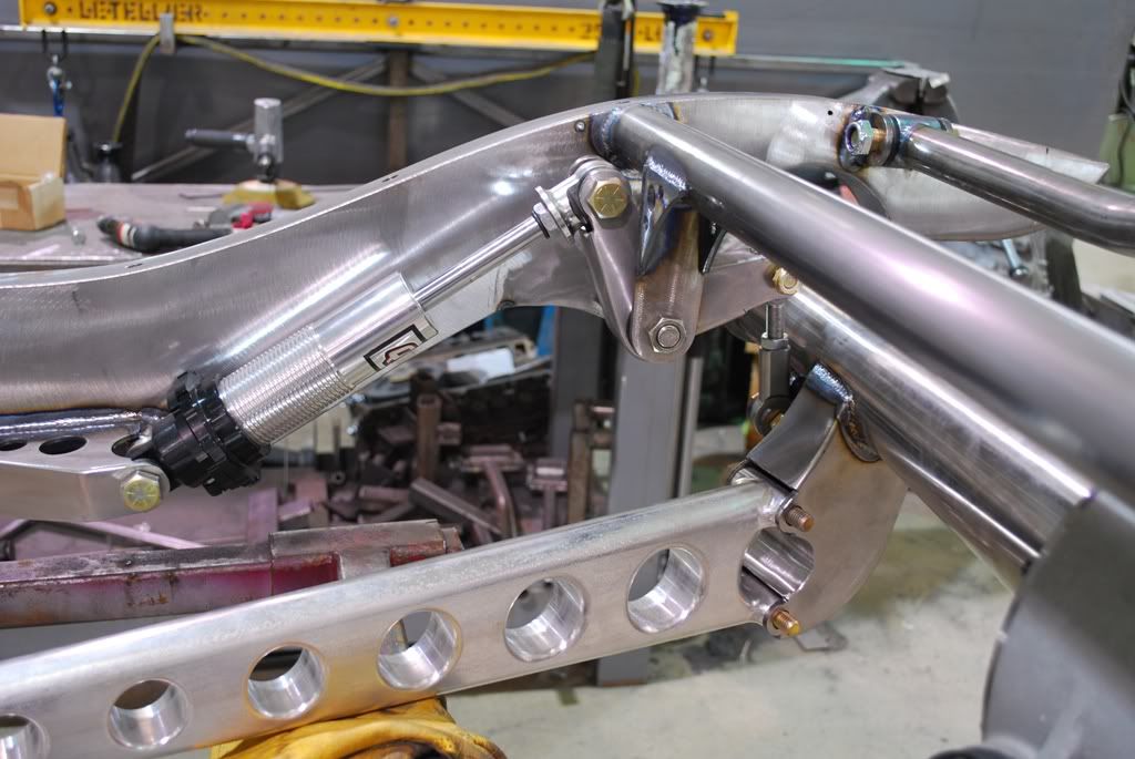

The customer didn't want to see the rear coilovers from the rear of the car so we mounted them on the frame rail with a rocker arm set up.

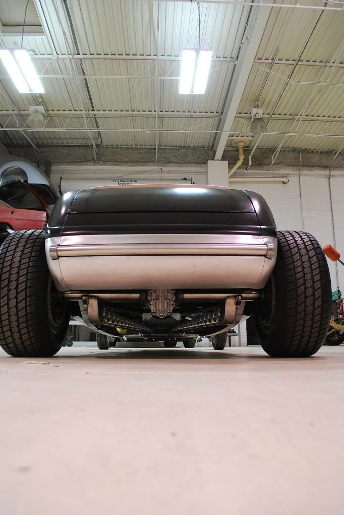

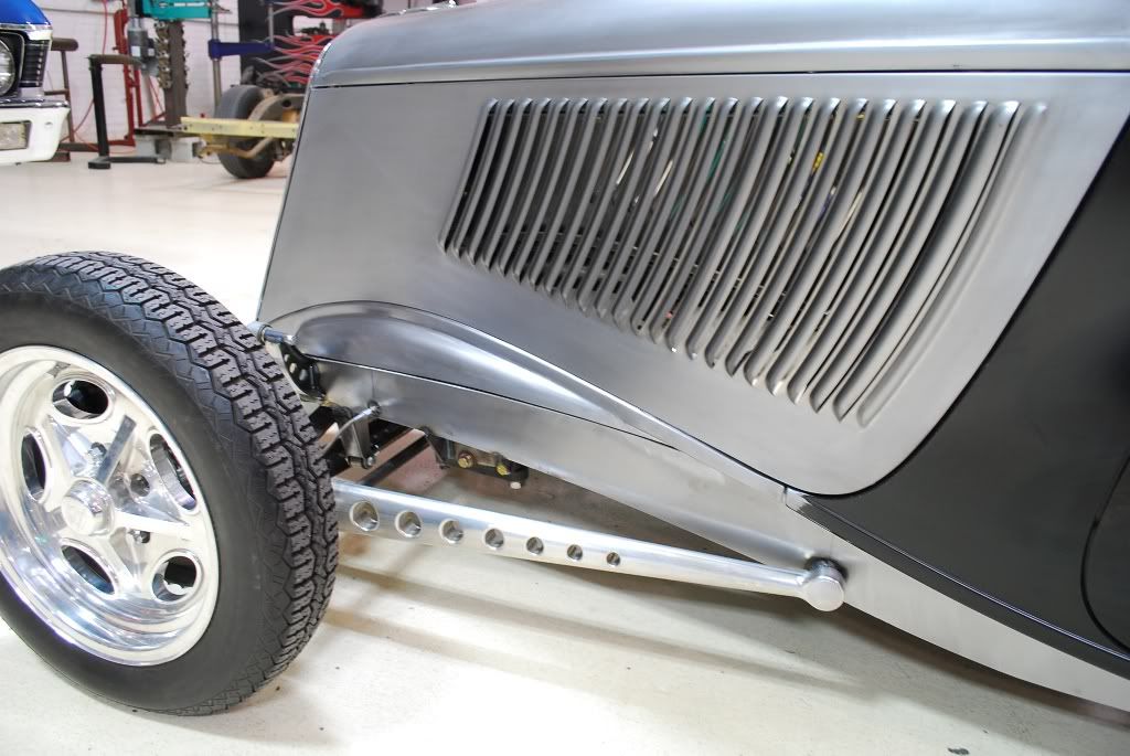

A few nice detail shots of the build. There is a full build up on our web site for those interested in the original hot rod stuff.

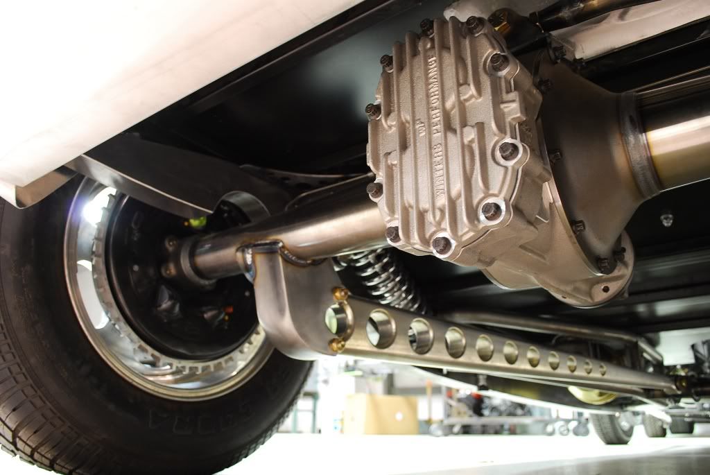

Really cool shot of the back of the car. It makes a big difference whent he rear coilovers are hidden. The split and drilled bones have a great look with the Q/C here as well. We also fabbed the rear section of the car to look like a variation of a stock gas tank.
Better view of the coilover

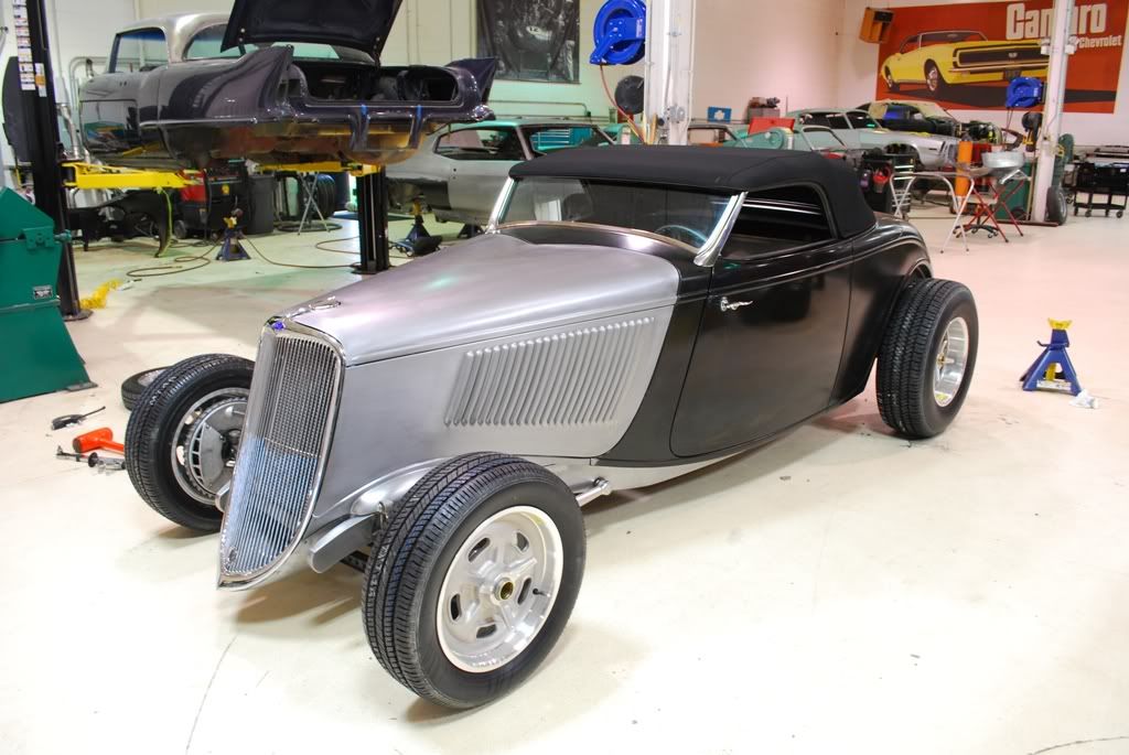

First look
Final look with black top and the So-Cal true knock off wheels.
