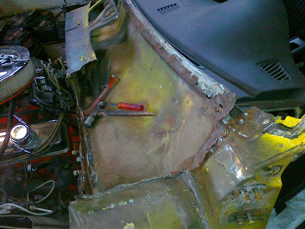

In the last pic you can see the raw bracket for the dash on the right side. It will be straightened up and fully welded while the cowl is opened up. Also some minor brackets will be fabbed to support plastic panels under the dash plus some other small stuff. I just wish the rust was long gone, so i could consentrate fully on the fun stuff instead:-)

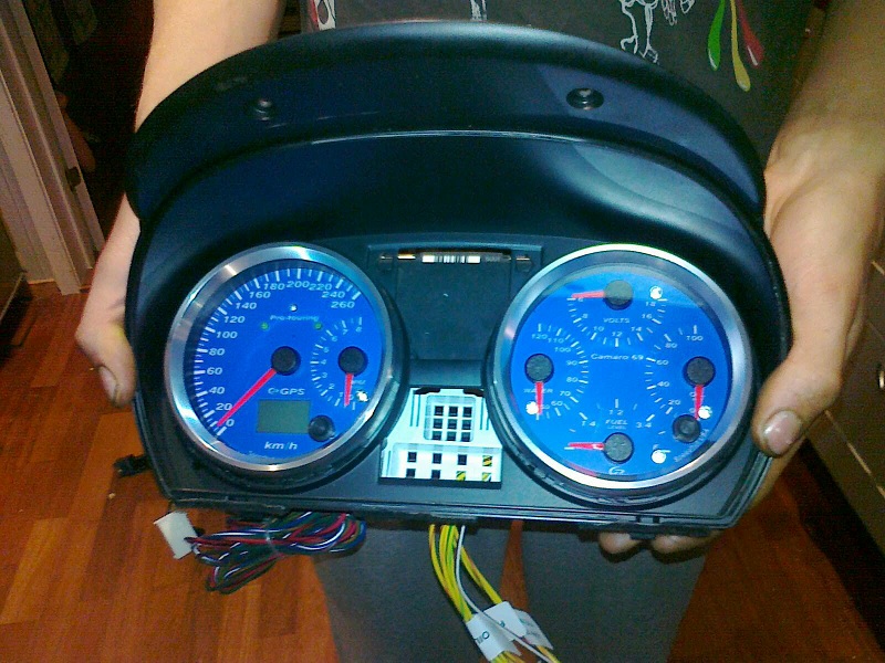

Got my speedhuts today, so had to test fit immediately:-)
I think this will be pretty nice when its done:-)

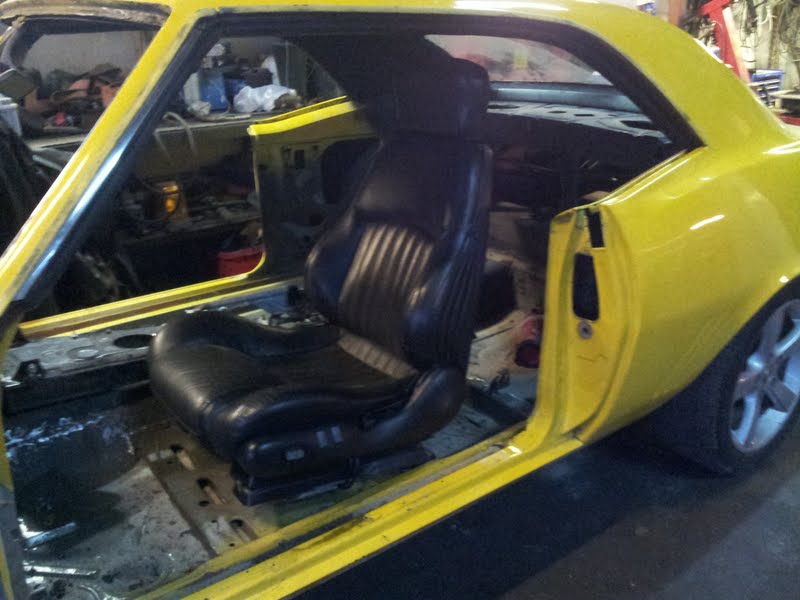

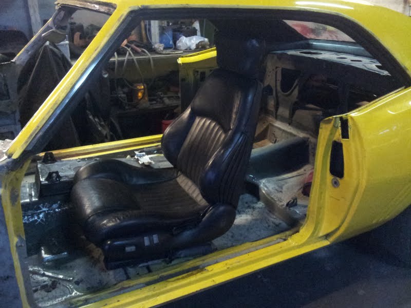

A small update- my seats arrived and just had to put one in to see how it will turn out. I think it looks pretty darn good! What do you guys think?..
Seems there wont be much clearance sideways towards the center console, but i think we`ll fix that. Havent tried the back seat yet, but will soon:-)
