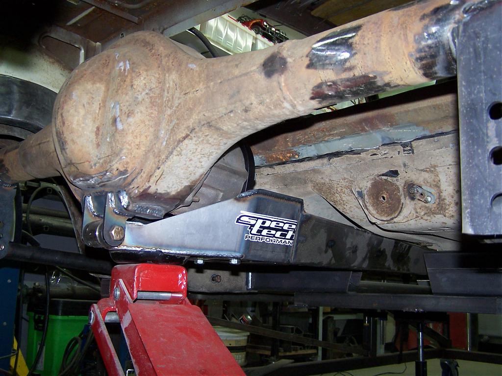

Join Date: Nov 2010
Location: osoyoos BC
Posts: 122
Thanks: 8
Thanked 77 Times in 48 Posts
I have moved the engine into the firewall 5". The v10 and the old 390 are the same length if you include the waterpumps. My number 1 cyl. is roughly on the the axle centerline. I am tall also but will still have lots of room for my legs, but I probably have 8" more of wheel base than you. The rect. stuff is 2x3 or 2x4 with .120 wall. The lower main rails are 1.5" round with .120 wall and the uppers are 1.5"rd with.065 wall. The small rd tubes are 1" x.065 wall
The rd tubes by the eng/firewall are 1.5" x .120 wall. The front frame rails will get a few diagonals yet. Tonight I bagan cutting out the rear floor above the diff. I have to raise the tubs and rails about 2.5" . Then that will tie into the rear of the tunnel tubes. This car will not be getting a cage or rollbar since I want to be able to use the rear seat. I will put bolt in pads for a removeable rollbar.

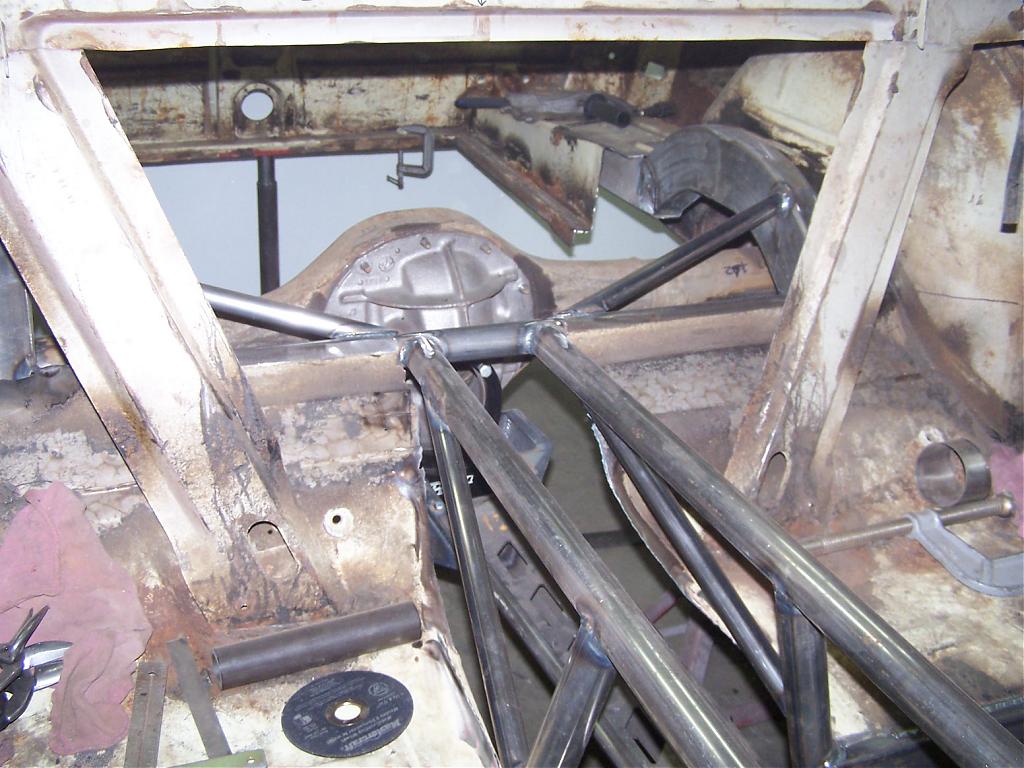

I have done this backbone setup before and it works quite well. The front and rear susp. is tied together this way and the sills are still part of the structure. I will be running a torque arm rear susp. and dual 3" exh. so that tunnel will be full. It also allows the seats to be mounted right on the flat floor if desired.

Got the rear floor trimmed away and raised the rails. Now I can get the Speedtech Performance torque arm into place and build the shock mounts.

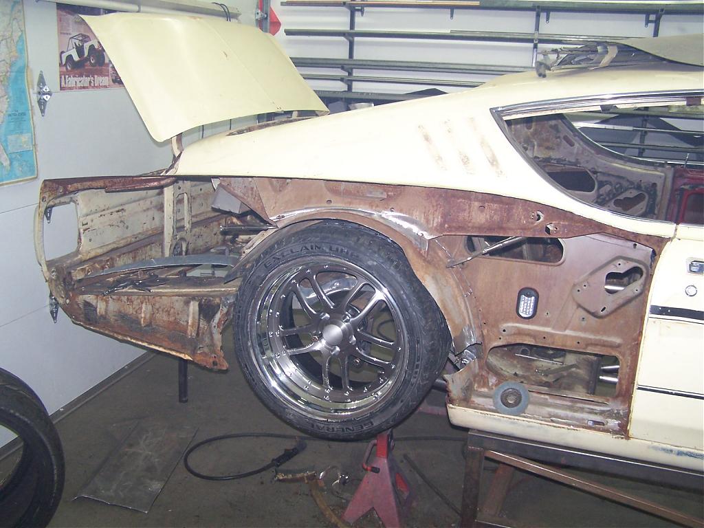

Then its time to cut off the quarters and cut out the tubs. The tubs get raised about 2.5" and then widened about an inch outboard. Going to be a busy weekend.

A few more pics of the progress. Will, you can see in the pic how I finished the rear of the tunnel.
The tub is raised 2.5" ,the tire is at full comp.
I found no surprises when I cut off the quarter, the driver side may be different though.
