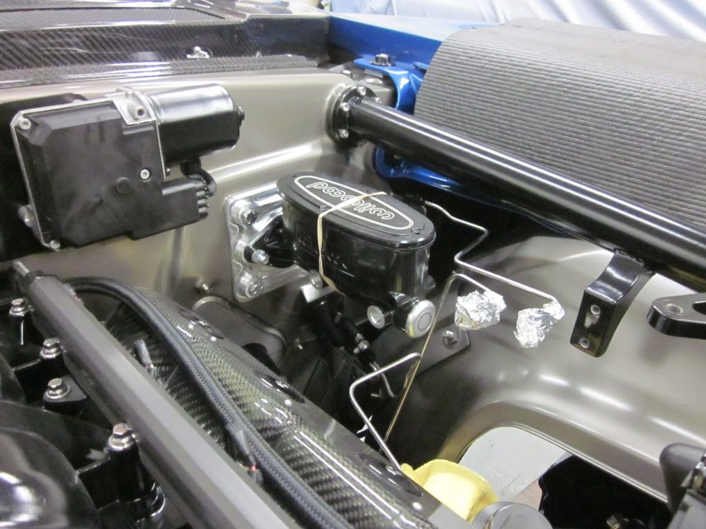

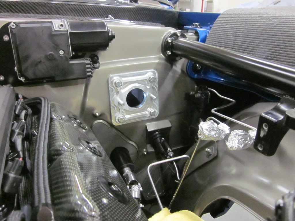

Thank you for the props Gaetano! But sometimes I do get into trouble..
So, the brakes on the blue 68 are not working the way they should.. Booster is bad.. pedal ratio is off.. the M/C bore size is needs to be smaller.. when we re-worked the firewall.. the booster was a direct bolt on to the firewall & we could not mount the M/C back on the firewall..
Solution: Machine a adapter plate to union both parts! I had to give up the nice pcs we did for the M/C with our reservoirs.. learned alot from this problem..

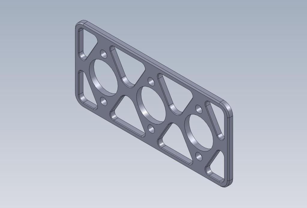

Ron is gonna be bugging me to use this new plate we just designed for the Wilwood tripple M/C with pedal assembly..
Dude knows how to push my buttons...
