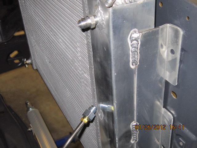

Here's my new fittings from Pure Choice. They fit perfectly. I just have the hardline laying up against the radiator. They had female inverted fittings that I can adapt to my fuel and trans hard lines. I do not like or trust compression fittings on stainless steel lines. These will work perfectly and solve my fears of the compression fittings.
Thanks everyone for your help. Saved me from a lot of frustration. Big thanks to Greg

You're welcome buddy -- that's what we're all here for!
Just don't over tighten those fittings... I like to "sneak" up on a seal... by tightening it just a bit then just back off a hair and then tighten it a little then back off and do it again to send it home. That way the two mating surfaces get to know each other and tend to seat better with less pressure.
