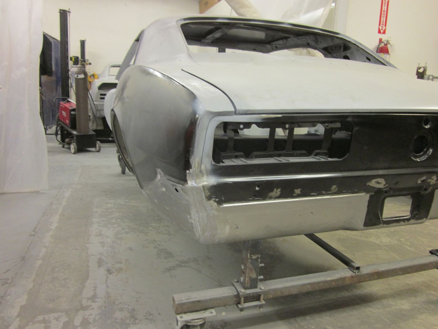

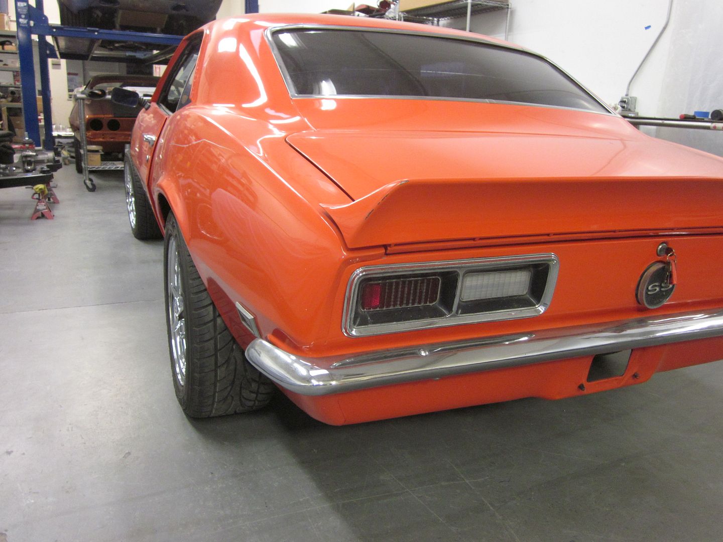

Stuart- The problem that I have always seen with first gen Camaro's is that they have a taper @ the rear.. & is a problem with the tires when you lower the car.. Here is another car 67 that we are doing that we removed the taper on the lower rear section of the car.. It still required for us to rework the whole lower section of the tail panel.. I plan on taking this approach with a 69 here pretty soon .. The front also has a nasty taper to it.. but that is boat load of work to remove.. I plan am on keeping finding methods of stretches that are suttle..
