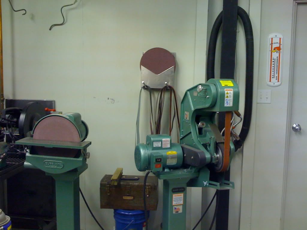

We had a hard time finding a grinder motor(local) w/the right mounting flange for the belt sander/grinder we bought.On my 12 disc sander I have a 1hp.I started out w/ 1/2 hp and it wasnt enough.Order it w/the jet unit.
