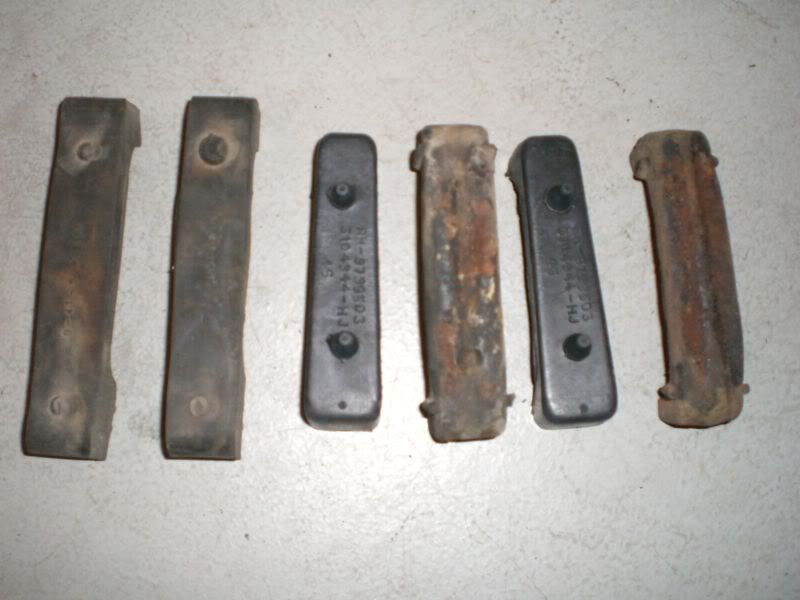

So i started to work again on the Buick, but things can't always go right !
My Ron Davis Radiator doesn't sit right in his upper mounts in the upper radiator support ....
I bought it from TA Performance, so it should have sits in a Buick !
Looks like you need different rubber isolators. Here are some that I bought and what came with my 68 GTO.
Looks like you need the long ones with the big openings which I cannot find.

In fact one of the lower rubber had moved and that why the radiator was not in the right place...
I didn't noticed it whan bolting the upper bracket
My rubber are right I wanted to replace them but they where out of stock by TA Performance (Buick specialist), i will check on my El Camino if chevys are the same.
