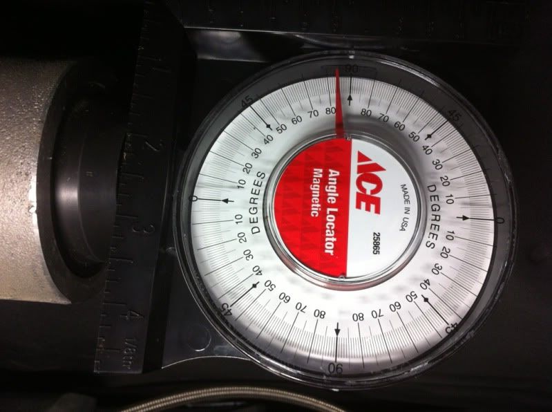

I got over to the car this weekend and made the crossover line for the fuel rails. Went a lot easier than I had thought. I also ran the fuel line to the rear of the car so when my tank comes in I can slap it in and finish the last line. Then on sunday I went to ace hardware and picked up and angle finder to figure out want my driveline needs to be at and try to set it. Heres what I came up with:
First reading on the tranny was around 84-85.
Then measured the rear which was around 90-91.
Ok.. so from what Ive read in the past I need to be around no more than 3 degrees for the U-joints to be happy. I'm off 3-4 degrees in total. So I went to the rear and adjusted the lower links by screwing them in some. Remeasured and came up with around 86-87. So Im around a difference of 2 degrees. Does this seem ok to all you driveline guys? I will be measuring and ordering my driveshaft this week now that thats done, or so I hope. Here some picture of the angles..
Tranny
Rear before adjustment
Rear after ajustment
Next up is a lot of wiring..
