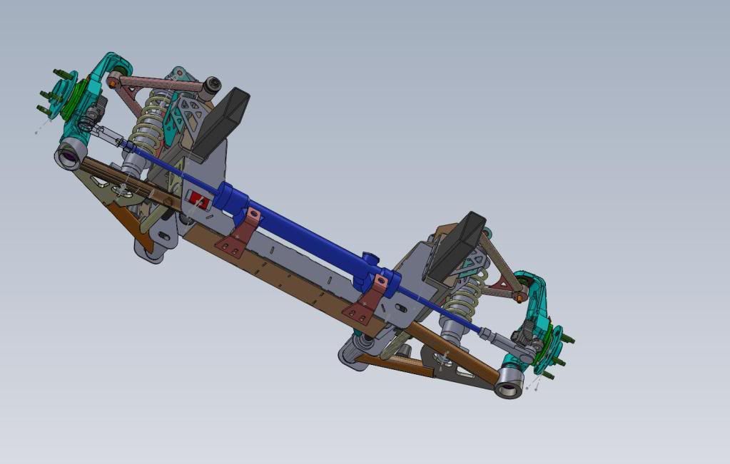

This suspension project has been kicking me in the ass! But the last minute changes have been worth it.. for the last few weeks we have be testing & tuning on BB.. & have been having alot of intresting chats with Mike Maiers..
The one thing that he has advised me on is make it simple to tune.. The shock bucket that we had before makes it difficult to change shock springs.. Re-design... We also have been running some pretty aggressive negitive camber... So we made it adjustable on the lower control arm by slotting & running camber washers.. Also Guy Ankeny will be working on the sway bar design for me.. I promise that it will be some thing trick with adjustments on it.. My learning curve this past week is being incorporated into our front suspension!
Cris Gonzalez

The front suspension design has been completed but had some changes that it needed.. WE got frame rails cut & will be water jet cutting later this week..
