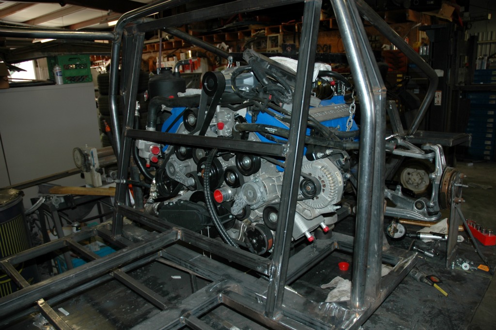

more pics of progress. Most of the chassie is done and as far as room it has as much or more than my camaro. I've moved the wheel bace 2 inchs for the extra room

I love this build. Awesome fab work! With no motor in the front they could move the toe board and pedals forward too.

Looks pretty sweet. What's going up front gas tank and a big trunk?

A couple more pics.Starting to mount all the petals,shifter,oil tank and fuel tank. Moved the rear wheelwells 2 inchs for extra leg room

Will you have some sort of forward access panel so you can get to the front of the engine for repairs?
Looking good as always.

Yes it will. The engine firewall will be 1 and a half inch thick that's insulated and removable,Hopefully I won't half to work on it. All i'm changing on the engine is the blower pully and a tune.
