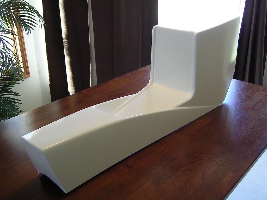

Here's the e-mail I received the day I ordered. It looked good to me so I went for it. Should see it here soon I think there were only a few orders ahead of mine.
"This console comes as you see it, the front and top of the tower will need to be cut to fit your car.
It is about 30 inches from the back of the arm rest to the face of the tower and it is about 10 inches wide on the face of the tower.
Check your measurements to see if this will work for you. The top of the tower ( after the cut to fit ) should meet the dash just behind the bottom of the ash tray and the back of the arm rest should sit above the seat belt bolts on the tunnel
We will need to know what type of shifter you have before we can install the cup holders ,we have had some automatic set ups that won't allow us to use our cup holders, there isn't enough room for the bezel and the cup holder."
  #16
Old 03-26-2012, 02:45 PM
dubbleu's Avatar
dubbleu dubbleu is offline
Join Date: Nov 2009
Posts: 81
Default Console

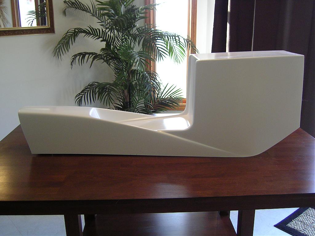

So its here and looks good. Once I trimmed it down to fit just under the dash. It ended up being about eight inches short (Does not go back between the seats far enough). Im going to cut it in half just in front of the storage compartment and add the extra length in.
Not a direct bolt in but lots to work with.
