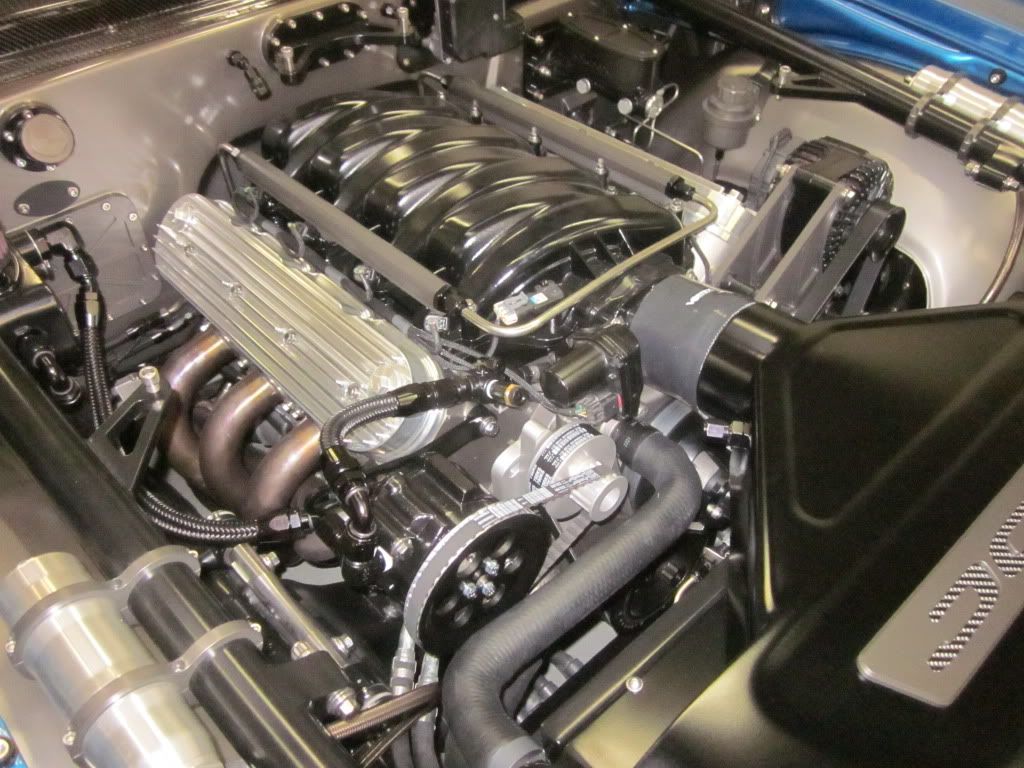

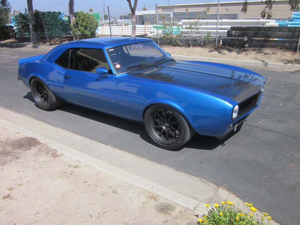

We made some changes to the engine bay... The compromise was the A/C for the time being... We added a vacuum pump because we kept getting oil from the valley into the intake... It seems like it works just fine... We also changed the valve covers...
Today I was at RPM doing some dyno tuning.. seems like we found a few ponies still hidden in the tune....
Instead of changing to JRI shocks we changed the tires.. Pilot Super Sports… 345 in the back & for the time being 285 on 18x10.5 in the front… The car seems to grip better.. We will find out tomorrow while we do some more testing…
The car will finally go home this week… It is time for Karl to enjoy the car!
