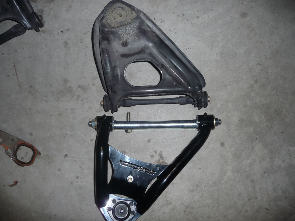

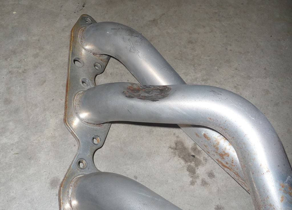

This is my first post on the forums and I want to see if anyone can help me with some upper control arm clearance problems. I have a 69 Camaro with a ZZ502 and Doug’s 320 headers. Last weekend I installed a set of upper and lower Hotchkis control arms and BB lowering springs. Well I should say I started. Everything went in pretty smoothly until I tried to install the passenger side upper control arm. It instantly hit the number four header tube. At first I thought it was a header problem but I had a set of Hooker headers laying around and swapped the Doug’s out but still had the same problem. I dented the Hooker header just to see how much room I would need and pretty much had to crush it in half to get the upper arm to fit. I put the old control arm back in with the Doug’s header and it fits perfectly with over ¾ inch clearance. Comparing the Hotchkis upper control arm to the factory arm the part#1107 is 2.5 inches wider and is 1.5 inches longer from the rear mounting hole.

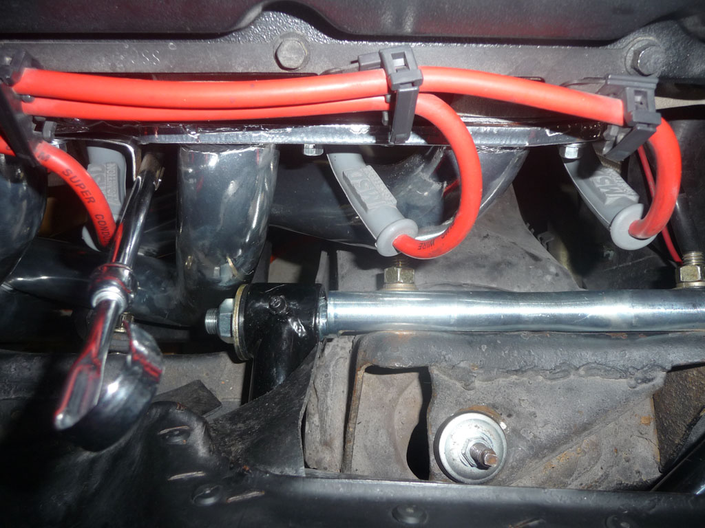

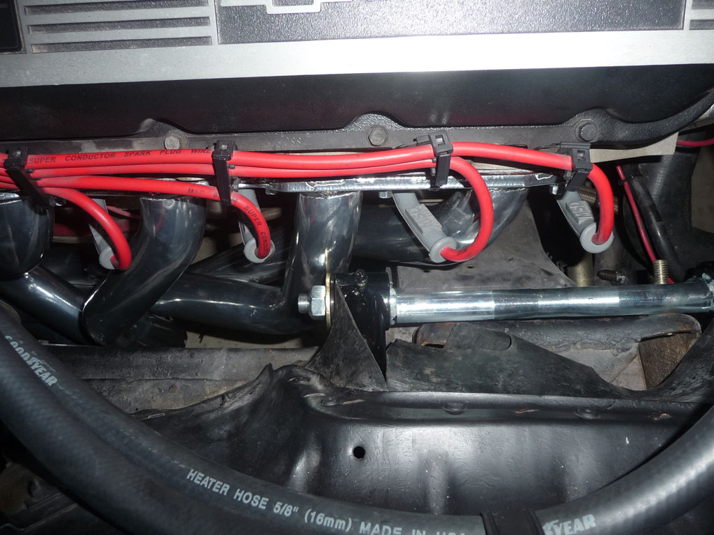

Thanks for the reply. I have just posted some pictures that I hope help explain what I am seeing. Drivers side perfect. And then the four passenger side images. You will notice with the new upper control arm install I can’t get the rear attachment bolt in without inference. I will call tomorrow and see if we can sort through the installation. Thanks for the quick reply.

Well good news. I double checked the measurements you gave me over the phone and everything looked correct. I flipped the upper cross shaft 180 degrees and the control arm slipped right into place. It is very close to the header but it fits. I don’t see a way a shim could be added for alignment purposes but I am back on the road. I attached a picture for you to see the clearance. For everyone reading I have the notched side of the cross shaft bolted to the frame. And for sanity sake the measurement from the front mounting hole to the bushing is 1 1/4 and the rear distant closest to the firewall is 1 3/4. Thanks again for taking the time to walk through this install with me. You were very helpful and went the extra mile to make sure I was taken care of.

That still looks really close, we had the same issue on big block before. Tried a couple of different headers some where better then others. In the end I took out the header and cut and rewelded the tube gave a little more curve to the motor and back a little if I remember correctly and then had them recoated. Yes this was a pain and cost the customer a few bucks but that's why we call it hot rodding. You may need to still move that harder tube once you go for your alignment?
