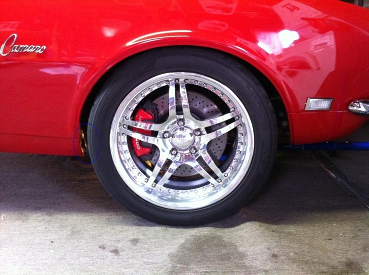

This got me wondering if my fronts were ever centered. I never measured exactly but this side pic appears that they are slightly back a bit? Look similar to yours Chad either before or after?
My last caster numbers were 6.34 left and 5.26 right. Stock sub.
I decided to go through my cardomain pics and forgot I had a pic uploaded of V2.0 with a 275 up front.
So my old set up looked like this when trying to stuff 275 up front with about 5.5* of caster. NT05 275/40/18 on a 9" wheel with 5.5" of BS.
R888 275/35/18 on a 9" wheel with 5.75" BS and 6.25* of caster with the TCI subframe.
Looking at these pics it seems pretty clear TCI does indeed attempt to duplicate the tire position as a stock subframe.
