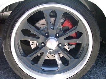

hifi875's Avatar
hifi875 hifi875 is offline
Join Date: Aug 2005
Location: bowling green ky
Posts: 816
heres mine!
