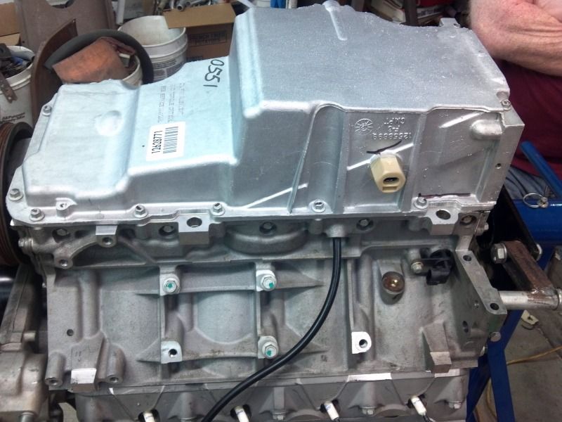

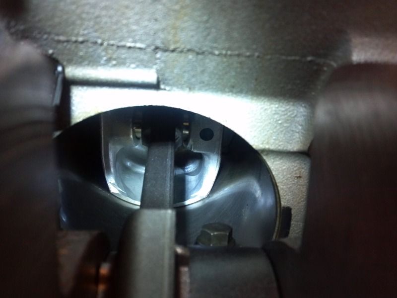

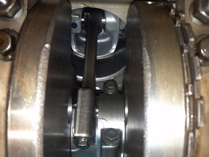

Well, because some people can't live without pictures (Jim!) Here are some of the LS6 I got from Greg. It's a very low mileage piece. The only thing he and I were concerned about was sitting in his shed for years. The concern was maybe it being slightly rusty or something in the cylinders or the other carbon steel parts. As you can see that was not the case. Looks brand new!
The only thing I knew for sure I would have to do is change the corvette pan out for an F-Body pan. After searching many sources for used, I got a great deal on a new kit from Pace Performance. Everything needed for the switch:

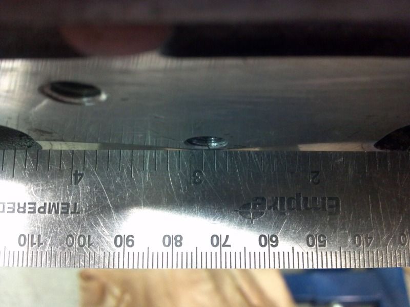

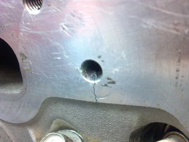

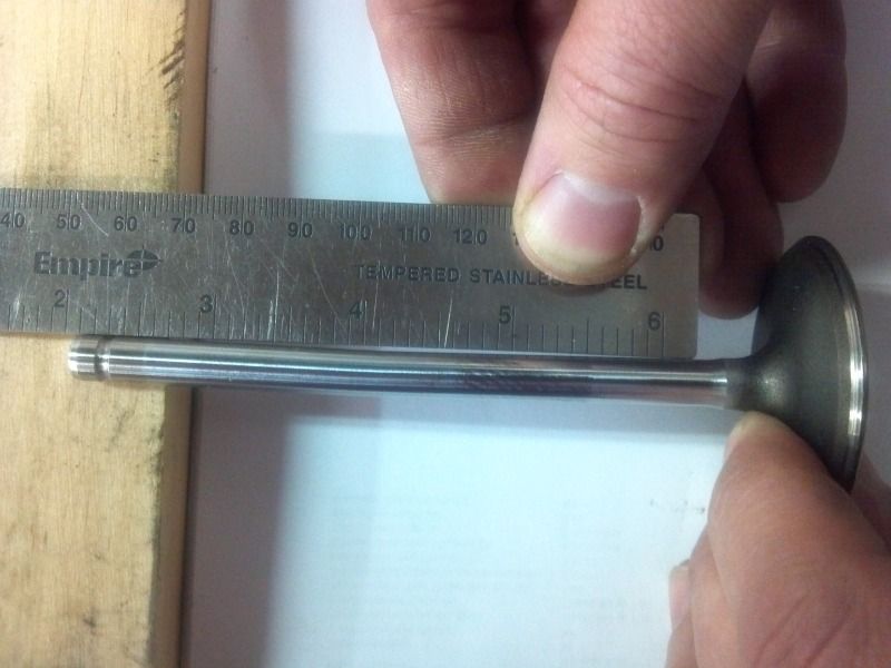

So I had that all buttoned up and was feeling good about getting the engine swapped. Then, as I was cleaning old duct tape residue off the cylinder heads that was used to protect the exhaust ports I found a problem. I'm not exactly sure how this happened, but I'm thinking the yard that pulled the engine used the exhaust manifold bolt holes to mount the lifting device. They must not have been flat to the head when they torqued the bolt. The drivers side head had one hole that was stripped and actually bulged and cracked the head. Check it out:

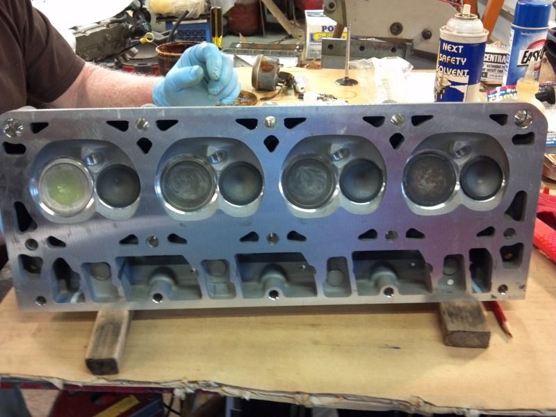

Greg never would have seen this under the tape that was used to cover the exhaust ports. So it was time to replace the head. I mentioned earlier the issues with discontinued parts. Here are some pics of the bent number 1 intake valve and some further damage to the same head. I think this damage and the bent valve was done in the wreck of the donor corvette. Upon further investigation it looked like the yard replaced the drivers valve cover and coil bracket. The valve cover had noticeably less dirt and corrosion on it that the passenger side. Again, this is something Greg wouldn't have known until he either rebuilt the engine or tried to start it.
So I got the new head casting and Intake valve which I mentioned in my earlier post as well. Here's a pic of the reassembled head.
