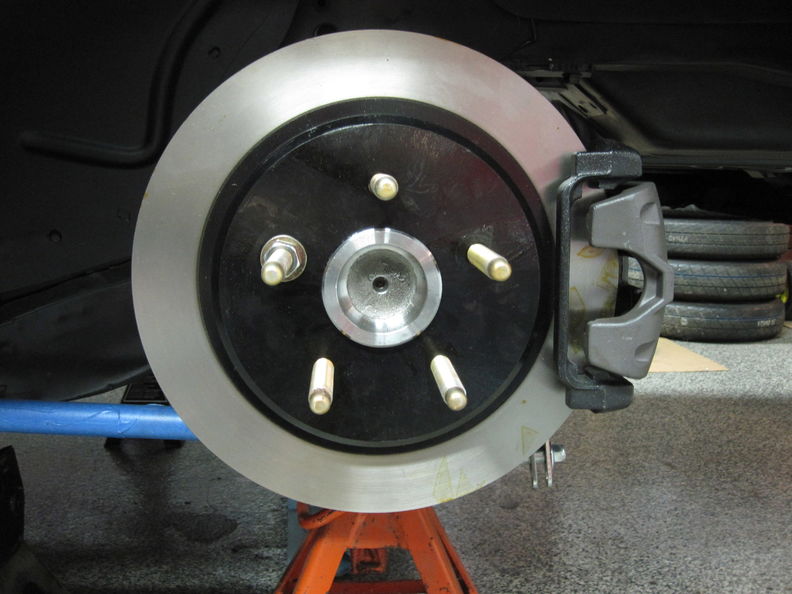

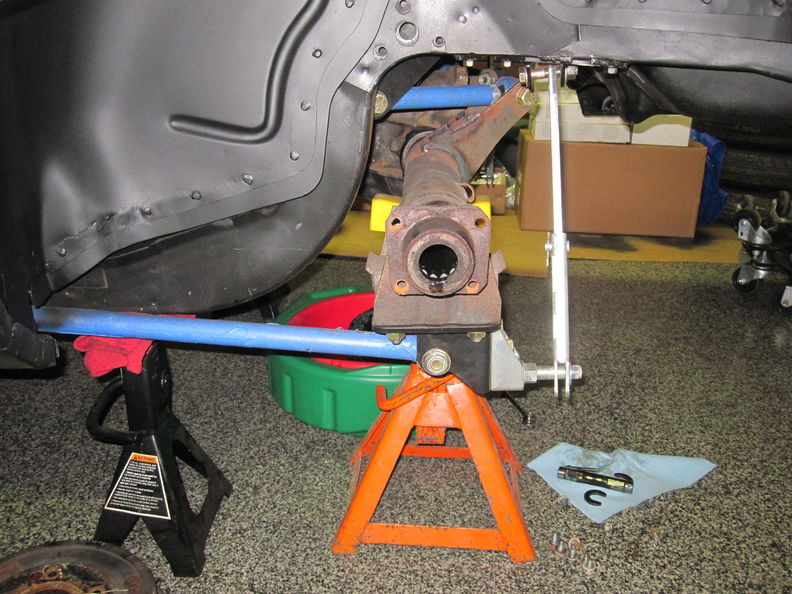

Installing the Kore3 brakes is so easy install even my 11 year old daughter can do it. First we remove the stock axles and original drum brakes.
Here is the complete Kore3 rear brake kit.
We installed the supplied bracket and did a quick test fit of the caliper.

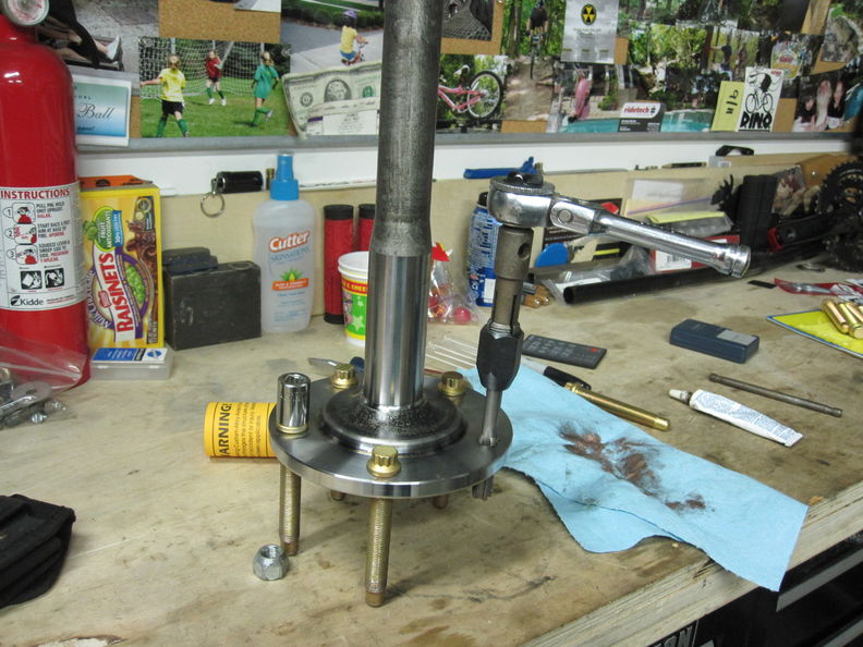

In order for the GM Rotors to fit on the axles you need to machine down the axle flange. Instead of machining down the 40 year old axle I called Moser and had the build a set of HD Axles with the proper flange diameter. My daughter ran the tap down thru the bolt holes to ease the install of the ARP wheels studs.
Like I said so simple a 11 year old could do it.
Final Install Picture and yes my daughter installed the entire kit with only a little help.

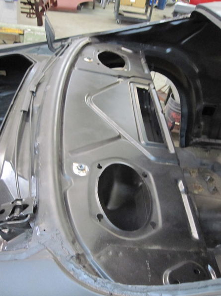

Since this car is being built to haul the family it's important to have restraints for all passengers. I had
the guys at High Speed Welding in Westmont, IL install a mounting point for the 4 Point restraints for
the kids. www.highspeedwelding.com
Couple Quick Pics
Sorry about the picture quality however you can see where the mounts are located.
Once the car is back together the plan is get a hold of the guys at Seat Belt planet to make some custom
seat belts for the kids.
