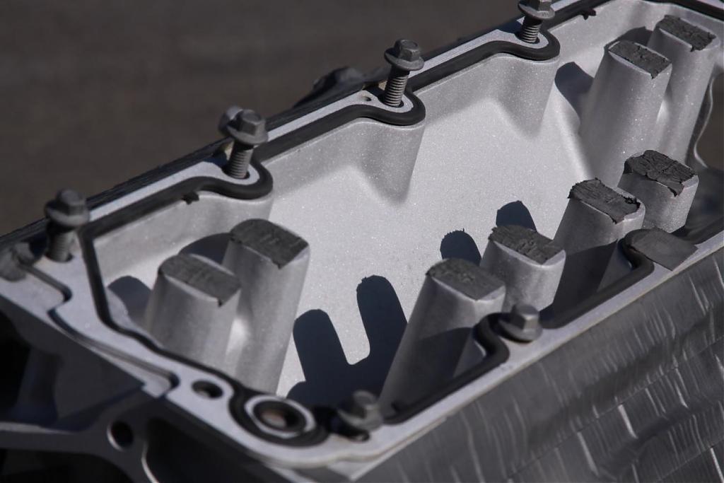

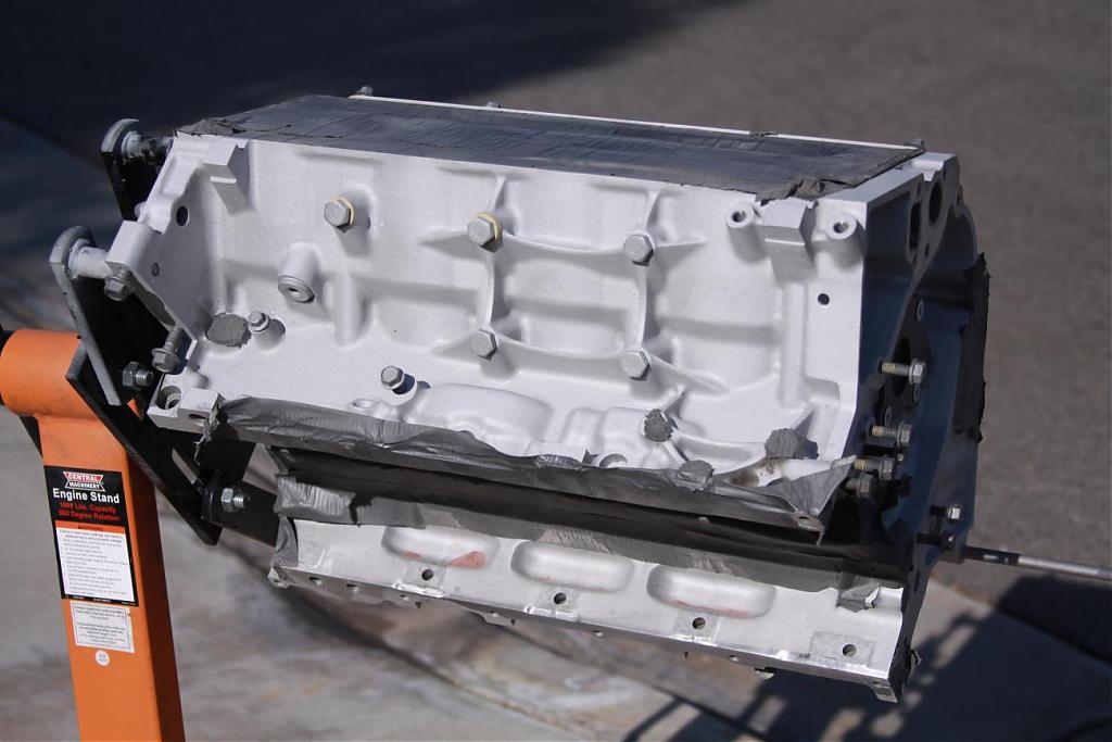

I figure I post an update on my son Nathan LS3 project. He finished removing all the casting off the block.
He even did the inside, LOL. Some body needs to take the grinder from him. Greg, you can say this is the "Freakin Cleanest Block In The Universe"!
Here is a in progress shot of the crank case.
Finished.
Next he had it blasted.
Now it's going to the machine shop to make clearance for a 418 forge internals. Any finally painted in a satin gun metal gray.
