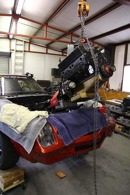

Engine refresh (check)
Ditch the TH350 trans (check)
Gear swap from 5.83s/spool to 4.86s/Torsen diff (check)
Brake flush/bleed (check)
Get a new manual trans since we sold the old one (check)

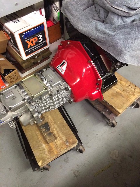

We opted to go with an American Powertrain TKO600 Extreme. We put a stock TKO in the car during the initial build, but found after 130 or so passes at the drag strip and a few thousand street miles, it wouldn't stand up to 7k+ shifts (as they said it wouldn't in the first place).
AP claims their upgrades to the TKO facilitate a higher power rating (not of concern to us just yet), and more importantly, much improved high RPM shifting (definitely of concern to us).
After several delays, phone calls, and other mishaps, it's finally in our possession and ready to be bled and tossed in with a new Lakewood bellhousing.
