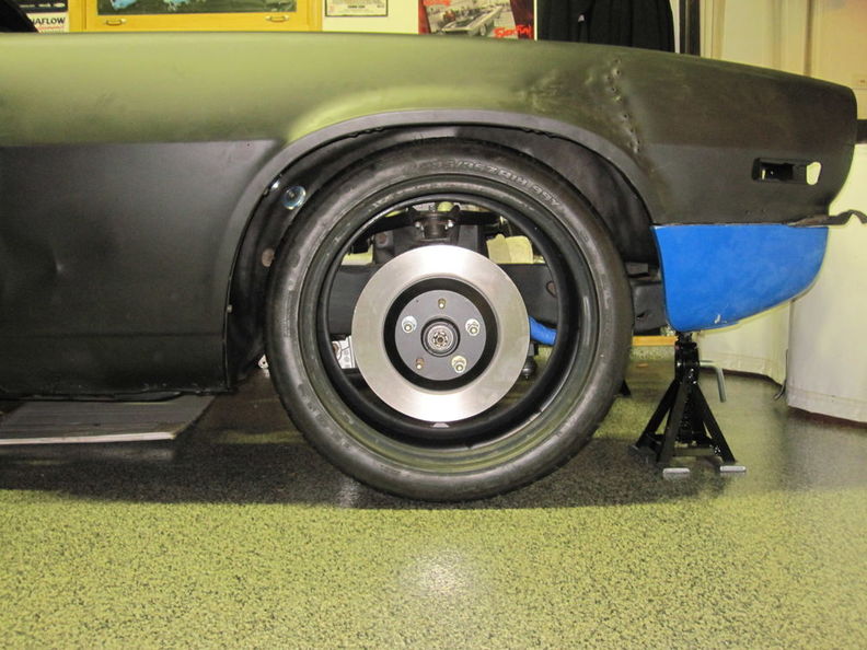

2nd Chance Camaro - Setting the Ride Height
2012 09-23 Update - Setting the Ride Height
www.2ndchancecamaro.com
Evening all,
Okay time to set the car at the desired ride height.
The front is going to need some work to get it a little lower.
Looks like we are off about 1 1/2" that should be easy to fix
Pictures hosted by www.garagescene.net
marty-mj

What size tires are you running front and rear Marty?
What size rims and backspacing? I'm sure others will want to know...
Welcome to the 2nd Gen 295 club!
Uhm I forgot
Rear's
18 x 10 - bs 6.75"
BFG KDW2 - 295 35 18
Note: The DSE Mini Tubs allow me to bring the wheels in way further then a stock set up and yes these tubs are well worth the money.
Front's:
18 x 8 - bs 5.75"
BFG KDW2 - 255 35 18
Special Modifications
Ride Tech Upper & Lower Arms
Mcgaughy Drop Spindle
1/4 Spacer
Bear Tracker Tie Rod Ends ( modified spindle mount )
marty-mj
