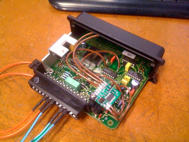

I've picked up a lot more electronics stuff. A few months ago I developed an add-on board that will convert almost any Volvo from the 1980s to distributorless ignition. It also adds launch control and shift cut (for full throttle shifting).
Here's a picture of it mounted and wired inside the ECU:

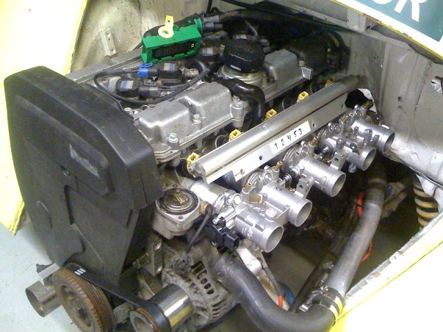

Alex and I have also dumped quite a bit of time in to this project. It's a 73 VW beetle rallycross car. It was purchased as a rolling chassis (stripped, cage, 911 suspension and brakes, slicks, etc).
We dropped in a 170hp 2.5l Volvo 20v 5 cylinder mated to a 4 speed vanagon transmission. Added a programmable EMS, coil on plug, individual throttle bodies, all new wiring, new fuel system, etc.
