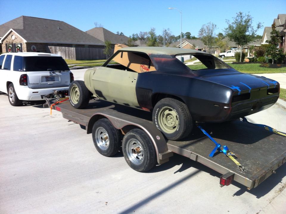

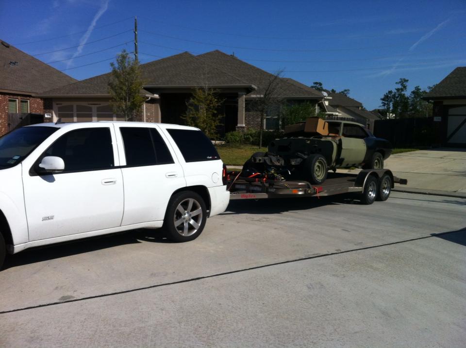

Car is back home in the garage. Wish I had taken pictures of the TBSS with the 69 on the trailer but I didn't get a chance. Far to hot to spend too much time outside!!!
Hope to have some time to get the front end on the car and planning to take it by a body shop to have them look it over and give me a good estimate on a paint job!
Car has come a LONG way in a short time man. She was in good hands up there at Camaro Concepts. Thanks again for the tow home, I owe ya one
