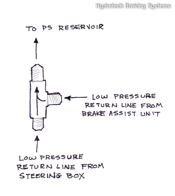

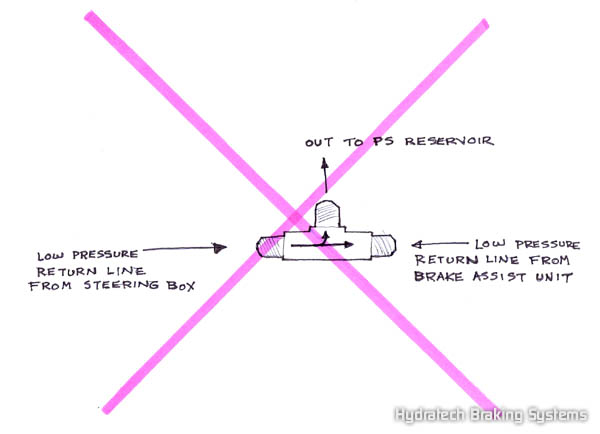

Do you have your T fitting oriented correctly?
Here is the proper orientation illustrated from a flow perspective:
Here is the INCORRECT T fitting orientation (which will cause the issue you describe):
Are you running a cooler or filter?

yeah!! I did that correctly. Pretty sur eit air in the system, we haev fought leaks all week!! I'll need to reblead tonight anyway as I have to change out a rear line. Paul if it doesn't get better I'll call you tomorrow
