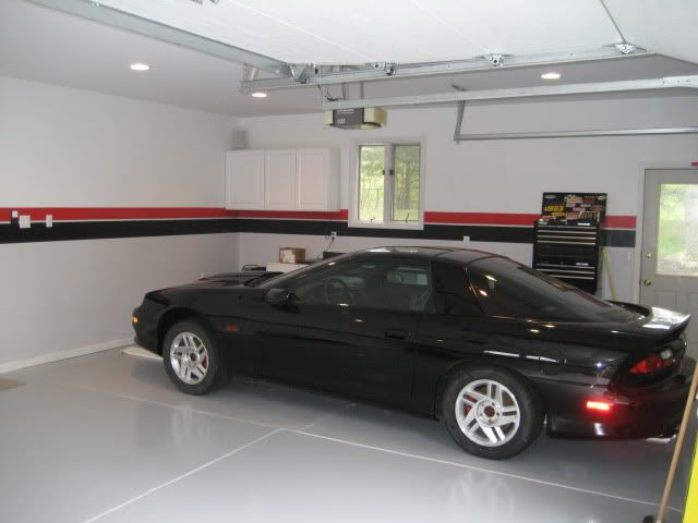

I had the floor in my garage rhino lined. It's held up great so far
[IMG][/IMG]
