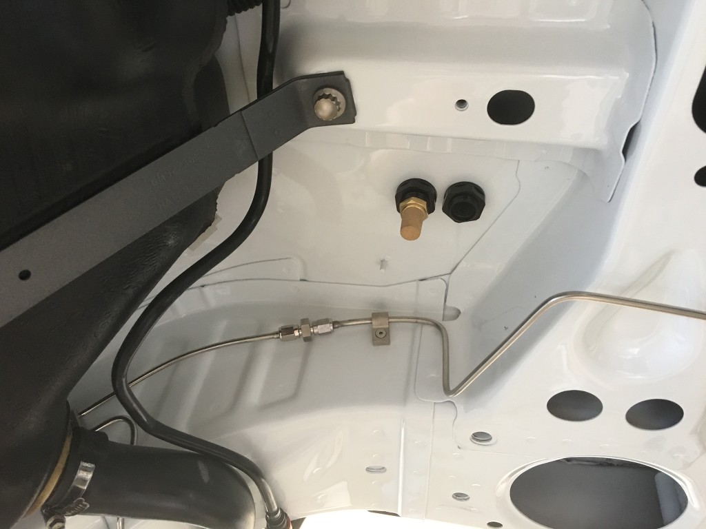

Extinguisher pluming.
Its all about summitry. A lot of thought was given to the routing process. Notice the lines follow the bead roll in the metal.
This one feed the fuel tank
Feeding the foot well
Feeding the fuel lines in the engine bay

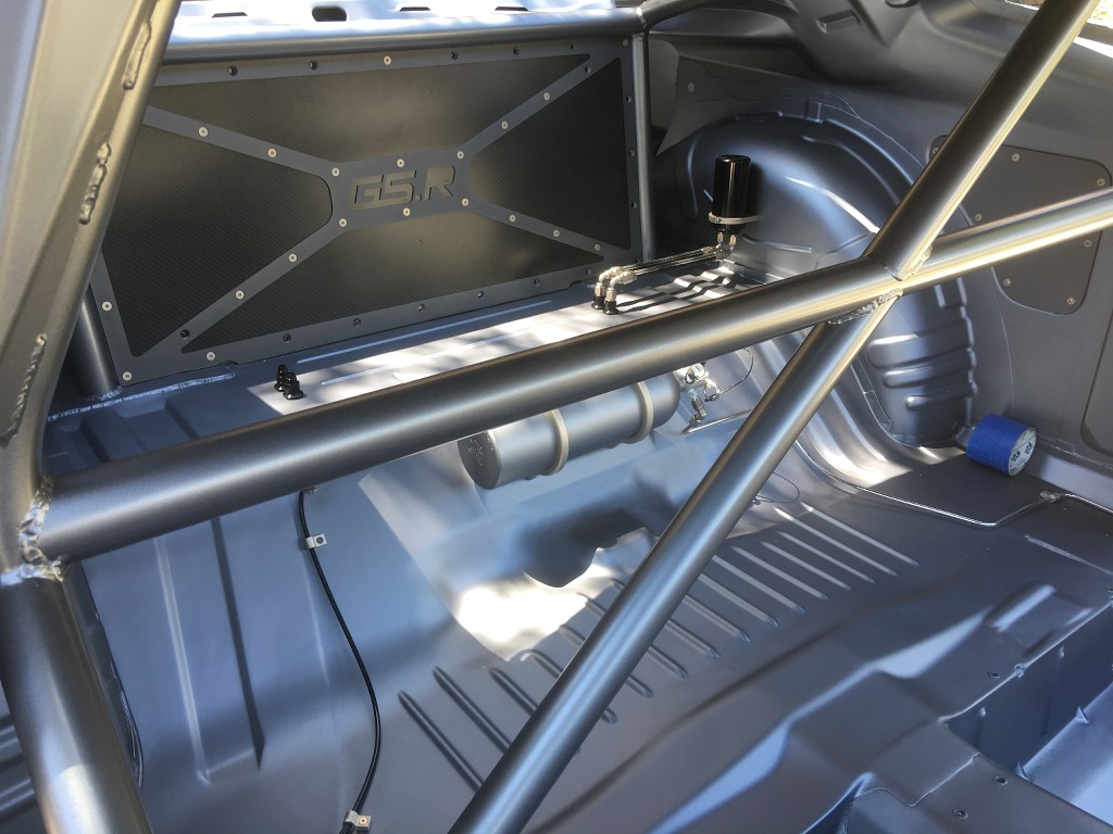

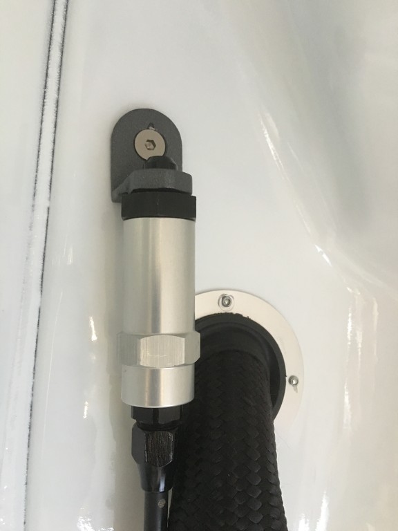

We used ll Much vapor canister for both the gas tank and the diff. We located on on each wheel well.
Here you can see the breather on the bottom side. Still need to connect the line to the tank in this picture.
Becuase we relocated the gas fill to the trunk, we had to come up with a solution for the vapor line, we used this slick valve that will close if the car were to flip upside down.
