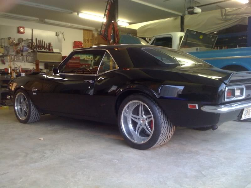

Originally Posted by John510 View Post
335s on a 18x10? You mean 18x12 right?
No they are 18X10 with 335's. The customer bought his own wheel and tire and I'm just building the car to fit them.
I am curious to see how a 335 fits on a 10 inch wheel
I will get some pictures when I get to the shop later today.
