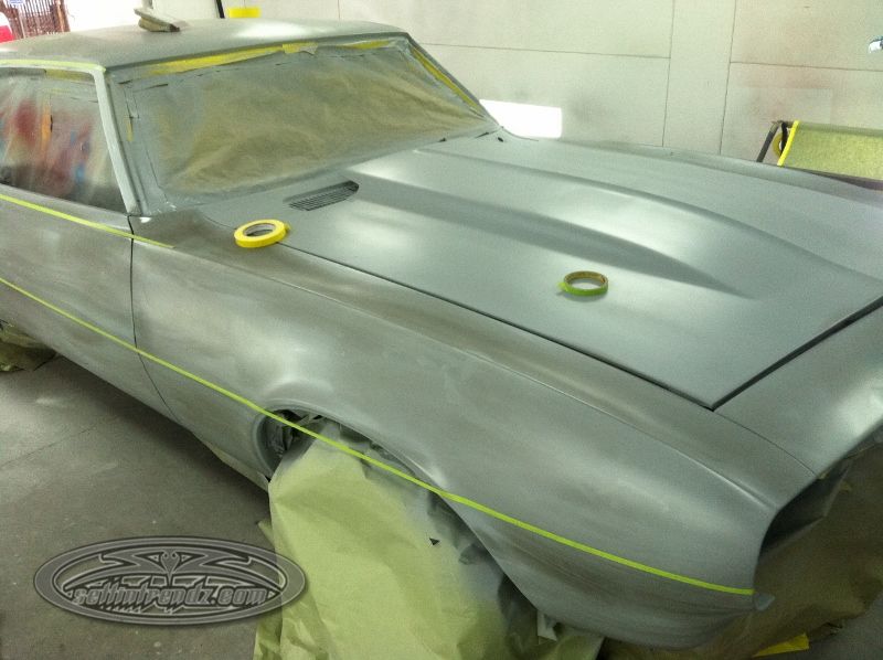

More Pics Paint in about a week.

Looks good Jay. I assume the tape is used to not ruin the body lines?

Yes keep them perfect and straight.
You got it John. We block up to the tape line (one edge is on the bodyline), then put the tape on the other side of the line and do it again. Like Jay said, it keeps the bodyline straight and crisp.
