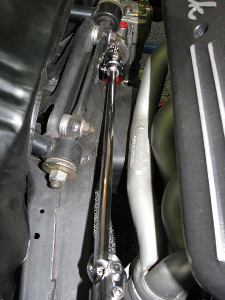

2nd Chance Camaro - Flaming River Steering Shaft
2012 11-15 Update - Flaming River Steering Shaft
www.2ndchancecamaro.com
Afternoon All
The stock steering shaft was ugly and I couldn't stand looking it. So a quick call to the guys are Flaming
Rivers and the new Stainless Steel steering shaft & universal joints were on the way. I know I could have
bought it direct from Summit Racing but they didn't have the lower universal in stock.
And yes I have a new rebuilt stock steering column sitting in a box.

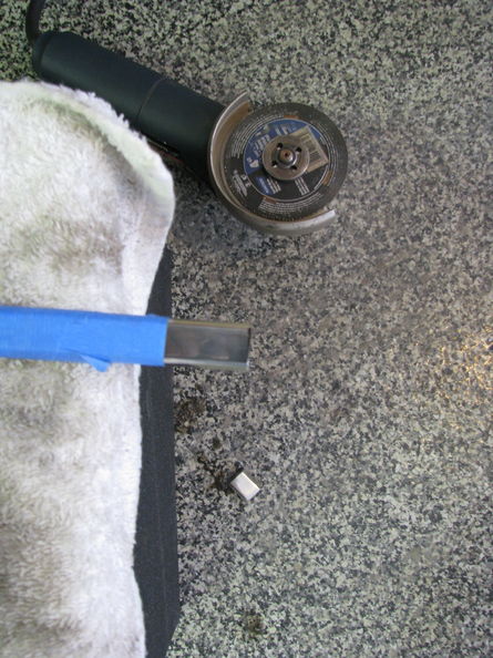

I put the Universal joints on both ends. Slipped the shaft into the gear box side and marked the shaft
were it needed to be cut.
Little more then an inch needs to come off.
Really it's straight - Honest !!
Installation is complete. Total time 45 minutes.
Parts List
FR2512DDPL 48 Spline 3/4" DD Polished $99.95
FR1850SSPL Stainless Steel DD Shaft Polished $85.95
FR2533DDPL 30 Spline 3/4" DD Polished $101.95
Pictures hosted by www.garagescene.net

I was asked by a couple people for the part numbers for the flaming river parts
So here are the part numbers
marty-mj

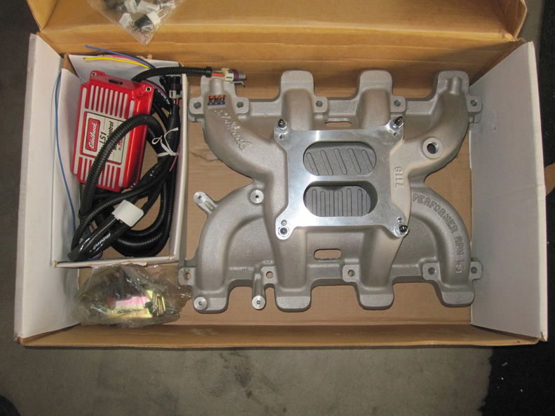

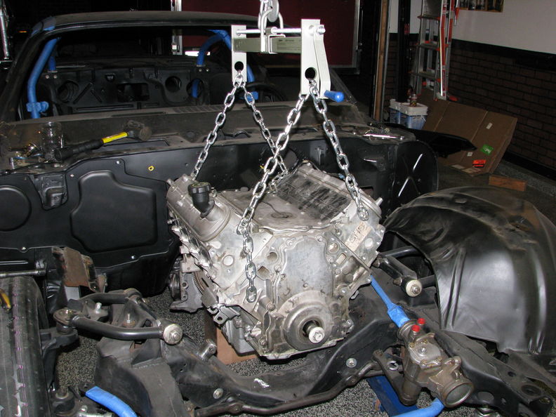

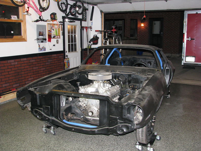

2nd Chance Camaro - LS1 is heading to Wegner Automotive
2012 11-19 Update - LS1 is heading to Wegner Automotive
Morning All,
It's time to get the motor out of the car and shipped up to Wegner Automotive. I have only heard good things about them. They are a full
service shop and they have some really nice Front Drive Set Ups.
www.wegnerautomotive.com
The goal was to get the motor out of the car and back to my office by the morning so I could ship it out right away.
90 Minutes later the front clip is off and the motor is out.
I went it early to pull all of the Motor parts off the shelf and I realized it looks like I have everything that Edelbrock offers for the LS1.
Yes it's a Carb intake for an LS1 and yes it's made in the USA !!!

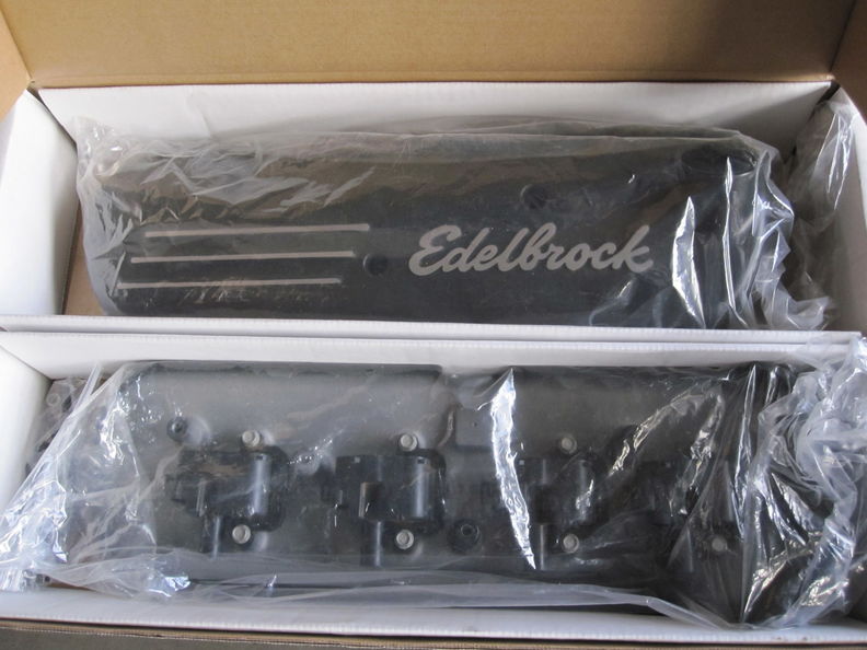

LS1 Coil Covers - wait till you see what we have planned for these
Valley Cover

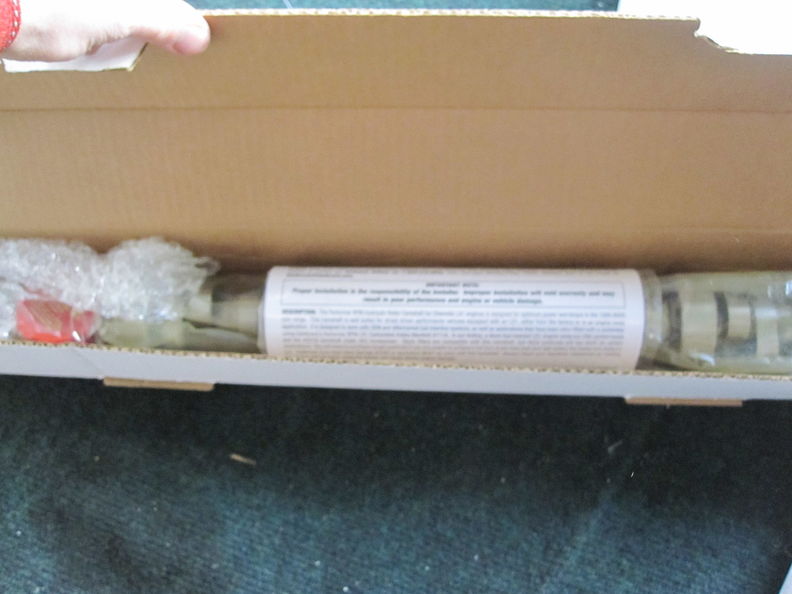

Camshaft -- Kinda looks like Kenny took this picture
Front Cover
The goal is about 450 hp which should be plenty for a street car.
