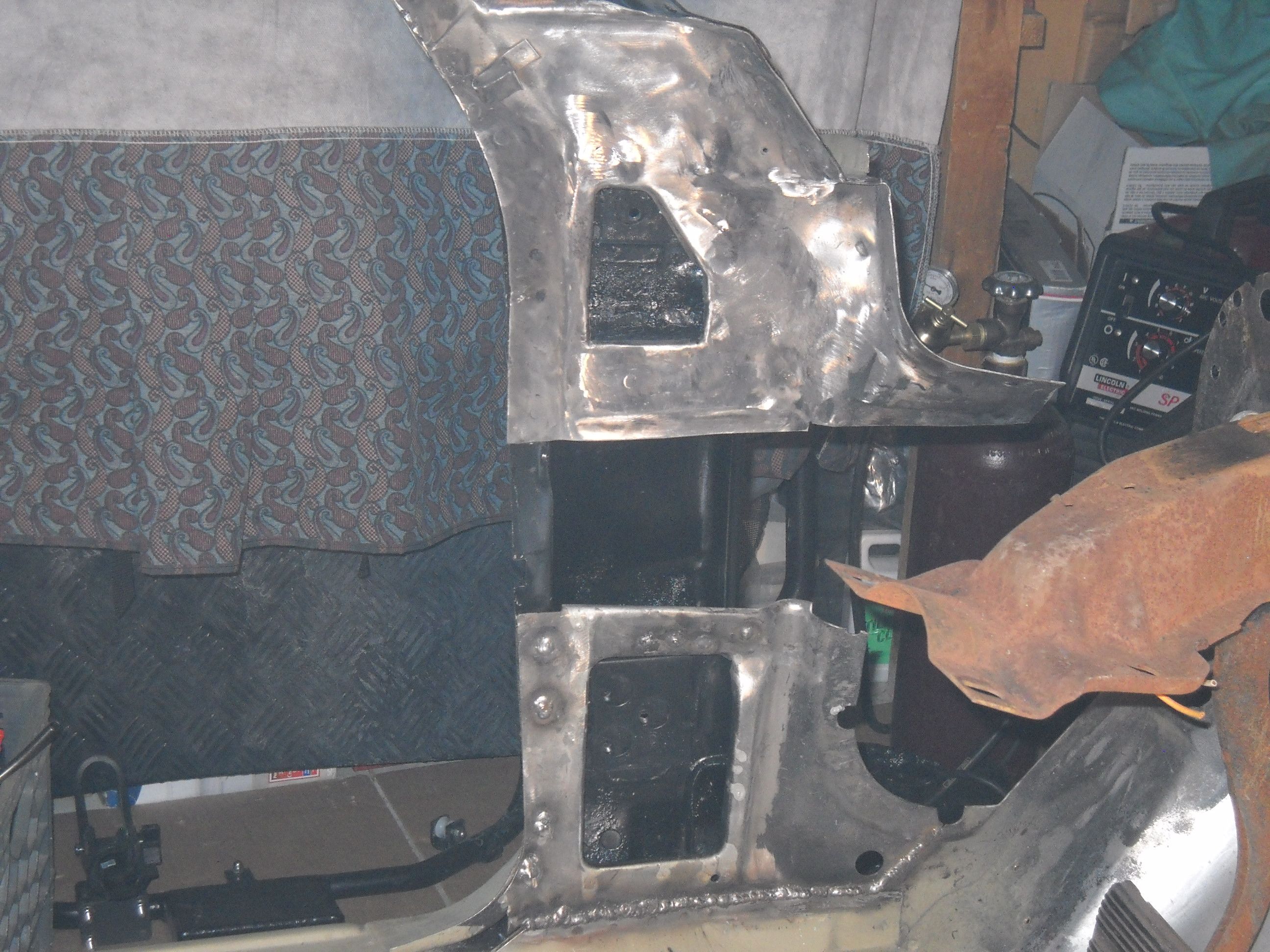

Got the patch pretty close to original, I could have keep messing with it but I needed to get going with the POR and not lose too much heat .... finished the welds and bought another 15lb propane tank in case this one goes empty.
So, here is the first coat of POR drying, another coat and then some black.
She's close, I'll finish trimming and hammer form when I get some heat on her.
Got the first coat of POR and the heat going!
Should get the upper and lower patch welded tomorrow if all goes well
Thanks for looking ......

I'm not sure I really wanted to post after seeing Mark has a new thread, new car .... I'm just chicken feed here with my little ol Camaro.
Mark will probably have two more cars finished before I get one out GOOD LUCK MARK!
But I spent all day in the garage so I might as well post some pictures ....
Better than before .... welded/POR'd and black
Welded the top , now need to weld the bottom and button this front end up!
Need to weld the bottom of this pillar and get the other side cleaned up and weld the cowl and sides then start on the firewall closeout and the dash ... but I'm getting ahead of myself, one at a time!

Thanks ... still picking at her, got out there and got the lower brace welded in!
Had to open the doors and let out the welding gases and lost all my heat so I'll finish this later Man it's cold outside!
This piece welded in makes this corner very strong!
