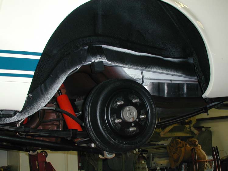

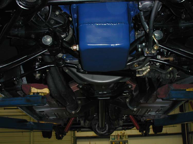

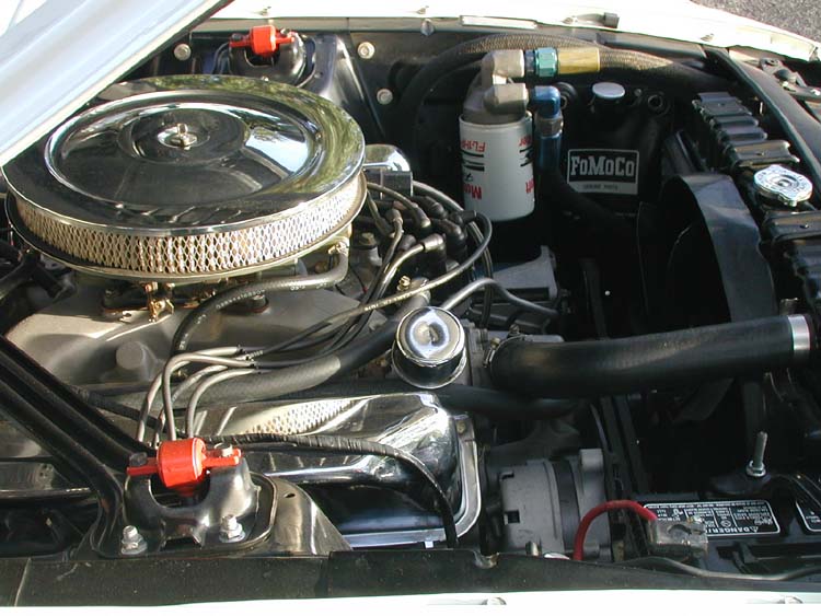

So I have also been doing a little more research on the 67 Shelby Super Snake
Some of the things which made an appearance on that car were;
Underrider traction bars, and Koni shocks
A remote oil filter and oil cooler;
Decent sized lines and fittings
Deeper oil pan
And LIGHTWEIGHT engine

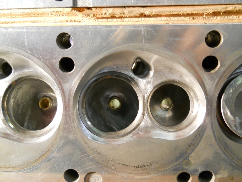

I did try a few times to get grinding on the other head.
For some reason on the second head my cutters kept clogging up. I was doing everything exactly the same.
Finally after four more cutter heads, I googled "head porting for dummies" and got the tips I needed for keeping the cutters cool.
Had a good run on head grinding tonight, and everything went okay.
