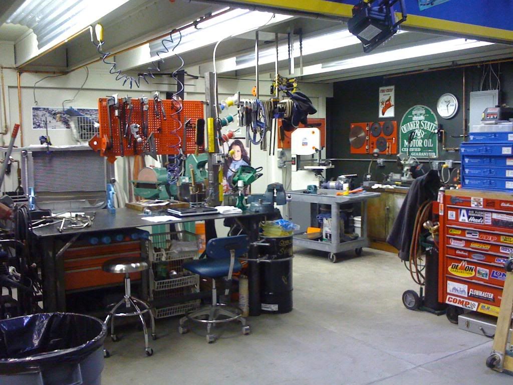

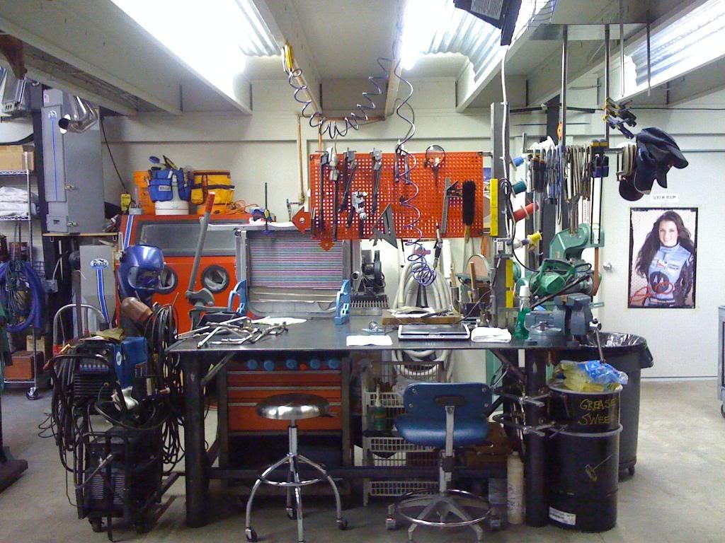

Right around 13' off the floor. I have one door that's 12' and I needed to clear that. Then there are 4 (dbls) over the work area that are at 8' ish....
The lowest lights are in the floor joists -- and I used some corrugated steel as "reflectors" ---- which I thought was very clever of me.
There is NO lighting above this area.... and it's still more than bright enough...
In this picture --- only half the shop lights are on -- the far bay is off. Each "bay" has 6 (2 rows of 3) double light 8' fixtures.

Nice shop Greg.
