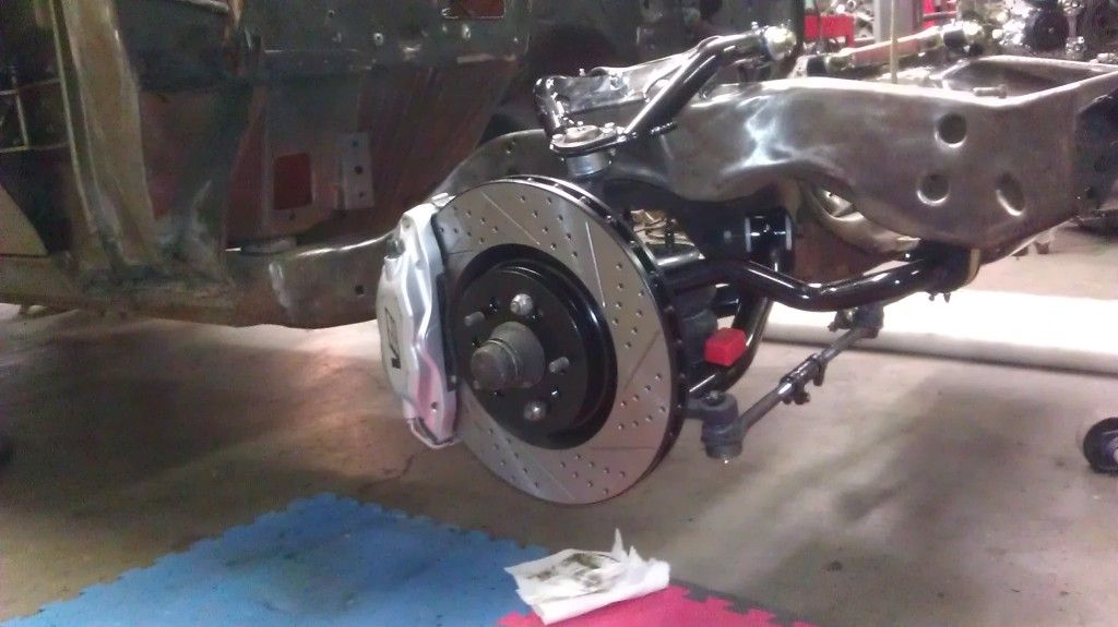

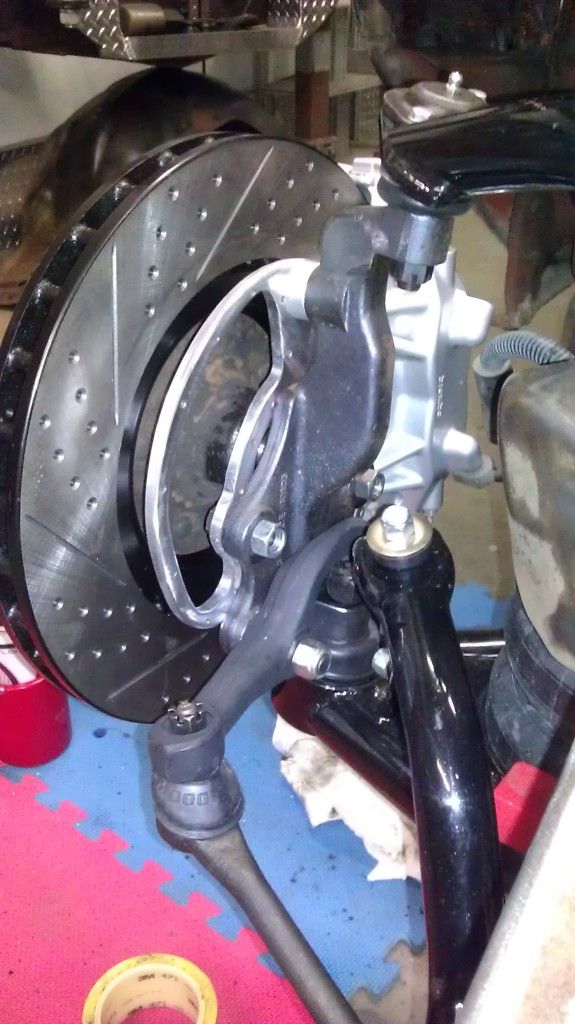

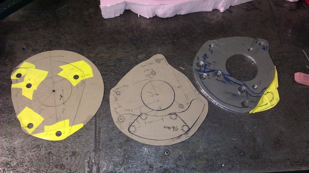

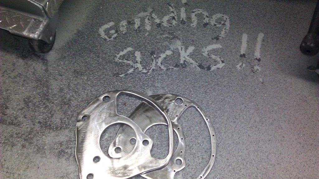

Ok so I have been lacking some new post sorry just been super busy. So here is were we ended up on the brakes fabricated some new brackets to mount the ctsv calipers to the fat man dropped spindles this was done old school lay out with a compass and protractor cut out with a plasma freehand and ground with a die grinder and a 4" grinder no fancy cnc. stuff here. the rotors were supplied by R1CONCEPTS they redrilled the bolt pattern for me as well 14" rotors do look dam sexy!
